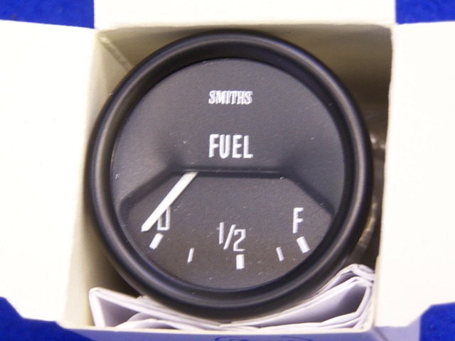

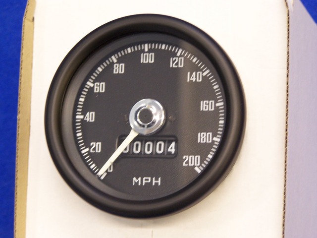

Some are not shown. RF and I'm told through Gary that uses the electrical or mechanical Smiths depending on the car. The mechanical black face gauges are right on, as are the SW mechanical black face gauges. The speed you show above is good, but the one on the website to the right is not.
The electrical gauges Smiths has are nice, but they don't look exactly right but close. Still, IMHO they all look better than the VDO beasts that lots of folks seem to use - that red/orange needle stuff on white just looks out of place in a 40. But, then again I'm one that thinks >16" wheels are bad too, and I know it is an opinion and not everyone agrees.

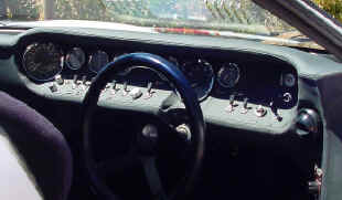

Here is a picture of my dash with Smiths classic gauges and I agree with Ron’s humble opinion that red pointers of VDO gauges don’t seem to suit a GT40 as much as the Smiths do. The steering wheel is a temporary one.

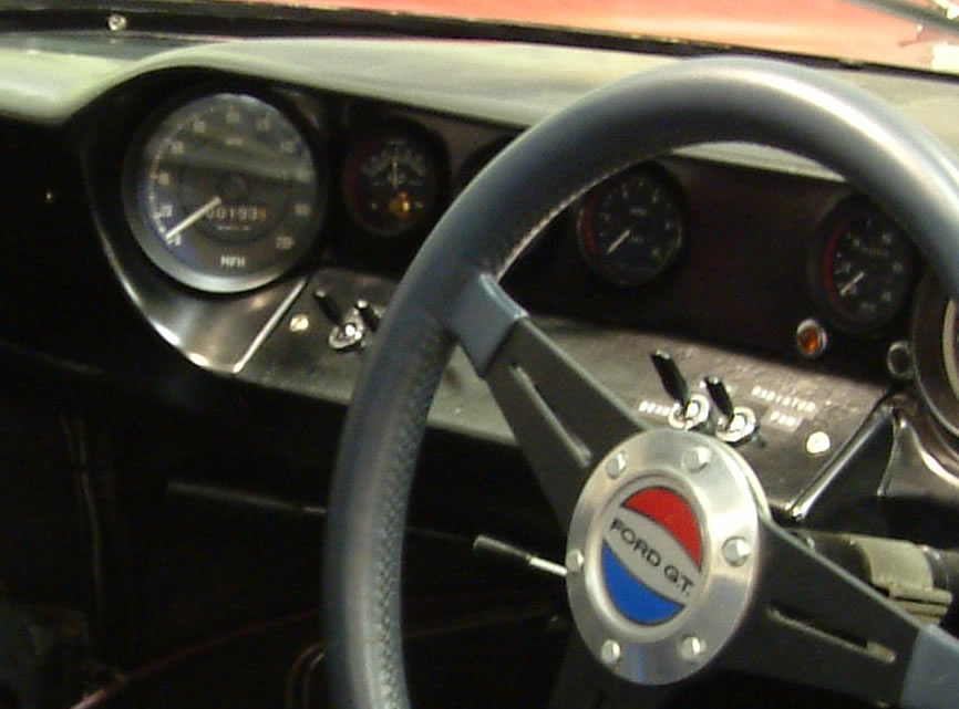

These are basically the ones but they should have black bezels and the 200 mph speedo read mph not km/h.
For final authenticity you can have red 'condoms' over the internal bulbs for the red lighting. This helps to avoid hitting cows on the Mulsanne straight!
Picture attached of 1089 one of the last.

Dave-
THAT is the picture I've been searching for - a closeup of an original. I like the look of the white pointers and black bezels.
Thanks everyone for the great help.

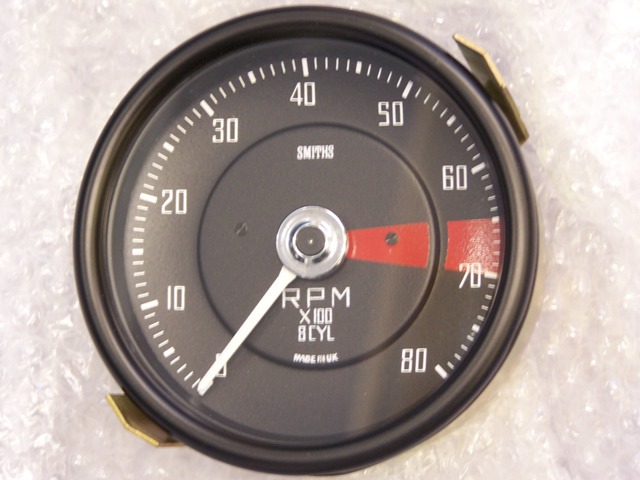

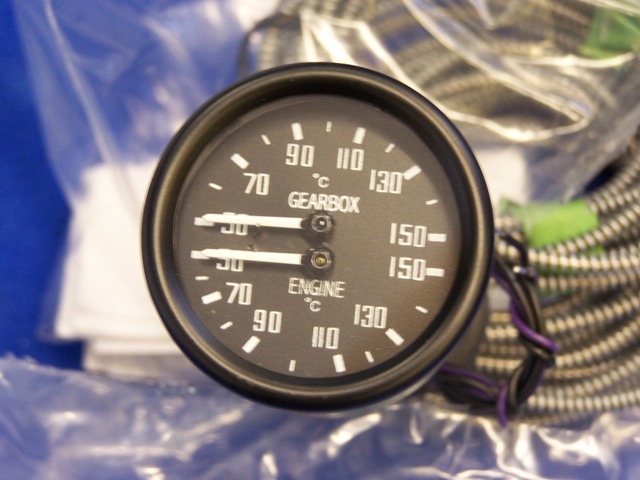

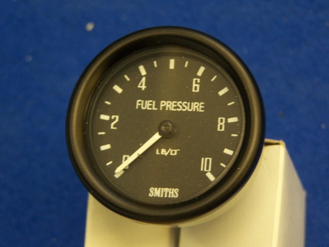

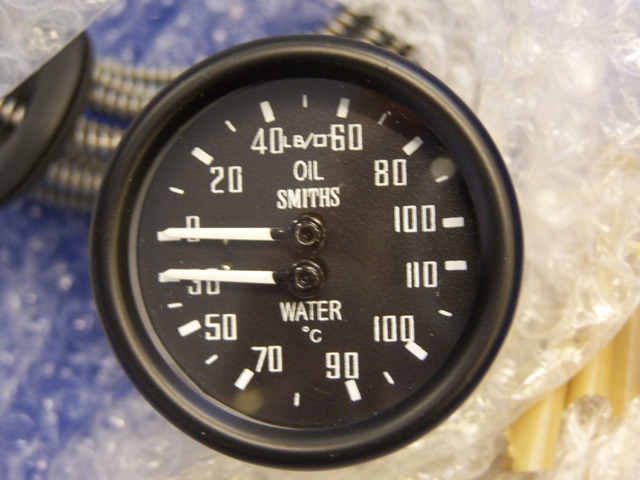

Finally got my instruments through from Caerbont.
It took a while!!!!!!!!!!!!!!!!!!!!!!!!!!!!!!!!!!!!!!!!!!!!!!!
I wanted to replicate the look of the originals but with some changes to incorporate extra measurements. I also decided to go with an 80mm speedo, as per some originals, although I now believe most had 100mm.

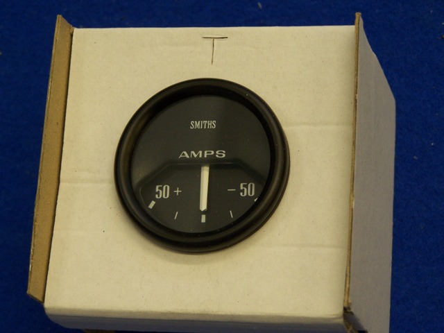

All gauges have half round black bezels to pass SVA. '1/2 V' is most original but will not pass SVA. Temperature and pressure are all mechanical giving larger scale deflection than electrical gauges. Originals were 270 degree mechanical. All are in original font, and have white pointers and red backlight as per originals. Original style fuel gauges and Ammeter are no longer available. I believe these are the closest available.
So either side of the Tacho I have gone for the oil and water gauges. In this case I decided on oil pressure and water temperature to the right, and engine oil temperature and gearbox oil temperature to the left, both twin mechanical gauges giving 180 degree scales.
At far left is the 200mph speedo, with no km/h and with mechanical odometer. I am using Porsche transmission which does not have mechanical drive so I am using an electrical to mechanical convertor to drive the speedo.
In between, instead of 2 fuel gauges and Ammeter, I am using 1 fuel gauge which will switch with fuel pump selection, fuel pressure, and Ammeter.
There was a problem with the red backlight (varying brightnesses) so all the gauges had to go back. They were then apparently modified to vary how far into the instrument each bulb is fitted, various different wattages are used, and they were sprayed white inside the casing. Hopefully they are all now about the same brightness.
Hope this all helps.
Pictures are shown from the right (RHD). I can arrange supply for you if you would like.

The fuel and amps are a different style, which is a shame, but I guess you have to have what they can provide...
