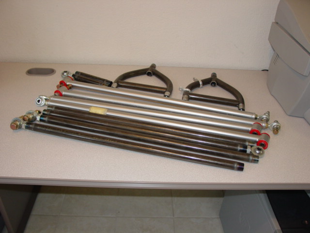

So I measured my wheelbase and it was 94 inches, a full inch less than what I need. There wasn't enough thread on the rod ends to lengthen the arms a full inch. So I remembered the pair of one-inch-longer trailing arms I had in the basement and I started playing around with the right rear suspension. Before I go further, let me follow up on Dan's last question and post up the sizes of the trailing arms I have (from the flat on the rear of the trailing arm to the center of the pivot hole on the front of the trailing arm. It's hard for me to accurately measure the lower arms that are on the car and I haven't taken them off (doing so will require moving the LP fuel pumps), but here are the approximate lengths of the three pairs of trailing arms that I have:
  • The long links that have been off the car are about 29-1/4".
  • The lower trailing arm links are about 28-1/4" long
  • The upper trailing arm links are about 27-5/8" long.

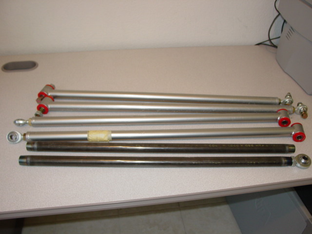

I have some 4130 links made up for the rear of a RF 40 (heim jointed). If your interested PM me and we can talk. left and Right joints so the adjustment is just like a tie rod. My originals are 30 and 29 1/8 (Centerline of the forward mount to the centerline of the heim).

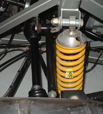

my upper trailing arms are about 28-1/4 inches long. This is using a tape measure with the little grabber not centered on the bolted joint, but to the end of the bolted joint (the one that connects to the chassis). My upper arms from chassis to upper hub face forward. I'll snap some pictures and post them.
