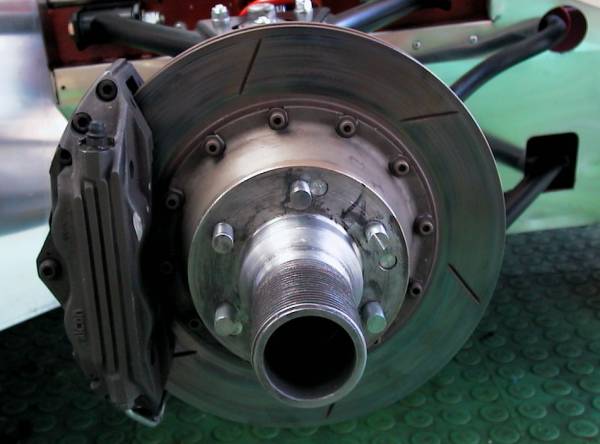

Alcon caliper as fitted to Roys Mk1 - an older photo as disc size was then smaller. /ubbthreads/images/graemlins/smile.gif

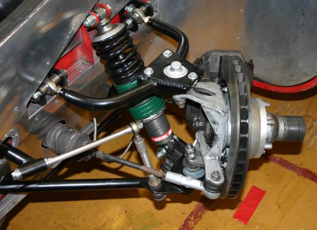

Bill - I have taken some pics of Roys new setup with 315mm discs and he is putting some words together re the process and what needs to be considered. Once complete I'll email you the pics + text - regards Paul
ps - here is a current pic of front nearside setup.
