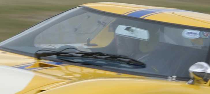

I suppose you mean something like the attched. The car in question is Robin Batt's 'Yellow Peril'. Speak to Frank Catt, he'll be able to help you.
Brett

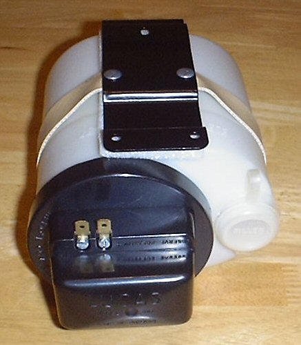

Here is a picture of the Lucas windscreen washer in question.
Again, does anyone know how many amps these draw???
Thanks,
Lynn
