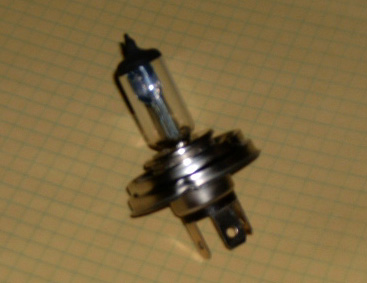

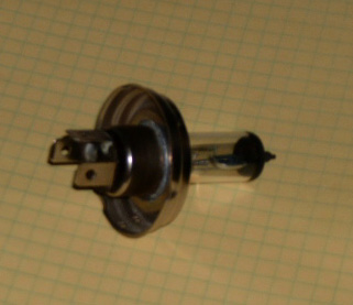

Canuk Here's some shots. This bulb has a larger diameter base than a current H4. But the lamp portion looks the same as a H4.

That bulb is an Osram #P45t, also I think you can get them from a Renaul dealer, they fit the lamps in the Renault 12
