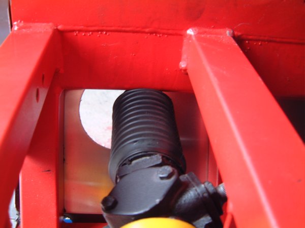

Rack gator rubs on chassis member and catches on external panel,this is the original position before the whole cradle was chopped out and done properly,it is now central and below, so no snagging. /ubbthreads/images/graemlins/ooo.gif

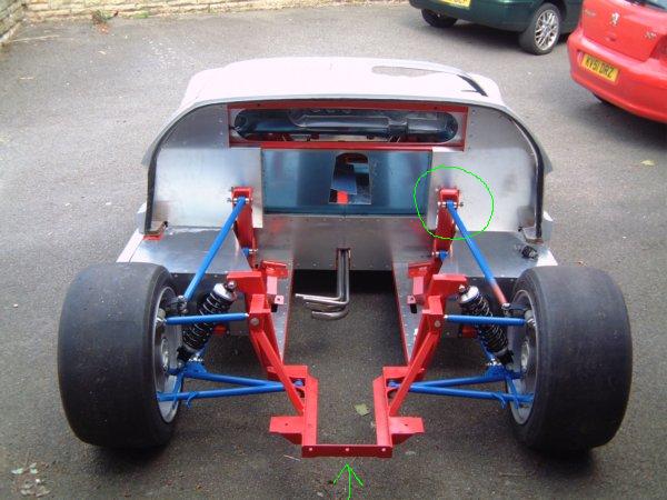

Chassis,you will have to save and zoom in on this one,most of the panels have been replaced with correct fitting ones.In the green circle where the rear top suspension link arm fixes,this upright part of the chassis is 30mm towards the rear than the other side,we had to cut the link rod,re-weld in the insert.Even with the rod end screwed in fully it needed 25mm off the tube,we have also brought out the panel behind it to cover up some of it.The arrow points to an area that was twisted badly,this gave different heights for the gearbox mounts,its not perfect now but it will have to do.

I took a closer look at the photo of the rear of your car. Your top links from the uprights toward the center of the car are located differently than mine. My links where attatching to the uprights, are mounted inside the hooked bracket that connects the upright to the upper link that runs forward. Also, does your chassis have the cross member that connects between the shock towers. How much of the car did you source from Mark. Things just look different than mine.

Yes yours does look different,could you take some more photos when you have time,maybe with the rear clip open so i can see alot better.
We purchased the body and chassis package,minus the steering rack and shocks.The steering rack is Ford Cortina as specified by MDA,shocks are AVO.Dont know about a cross member,does this also hold the rear swaybar,not sure if this is part of the chassis package or not.

The first big issue concerns the ally panels, these were added to speed up the build, we had ordered a complete set inners and outters. Some fitted o.k. others were iffy and there were some that were beyond belief. Over the next few weeks Mark gently made us aware that the suspension attached to our chassis did actually belong to a Lola and could he have it back please!, that's why Lee said it looked a little odd, those alarm bells are now getting quite loud now. Emails and phone calls were exchanged over the ensuing weeks, some were really quite acid in their content. It became clear that we had indeed reached impasse. I locked the garage doors and didn't go near the car for weeks, this was quite a depressing time for me and I did consider that perhaps I was expecting to much from a kit car. Could all those stories be true about the early GTD/KVA kits when after buying your body and chassis you are also given the address of your nearest scrap-yard where you will find all the parts required, but that was thirty years ago, things must have improved since then! All this was not helping, my relationship with Mark and MDA remained cold. Something had to be done, so I asked for a complete refund which I really didn't want because it meant that I had given up, Mark was understandably reluctant to do this and in a strange way I was o.k. with that because it would mean something would have to give. The relationship began to thaw after Mark offered to deliver, in person, an exchange set of panels and swop the Lola suspension for the GT. The garage doors were flung open to receive this new air of hope and expectancy, oh, by the way Mark this floor pan you sold me, can't quite get it to fit, [MARK]....er...er.. that's because it belongs to a Lola as well! Will somebody please turn those bloody alarms off!!

The next big problem was the steering rack, Lee has already posted a photo of that, the whole lot had to be chopped out and rehung. the pedal box was designed to fit over or under the two rails it did neither, this also had to be chopped and re-welded in it's correct position. there's other stuff which I can't be bothered with right now.

On your steering rack keep in mind that moving the rack in relation to the suspension changes bump steer and/or ackerman. Moving the rack vertically changes bumpsteer and longitudinally changes ackerman.

Hi Jim D
In my opinion the short upper links should be mounted on the other side of the upright,to me it makes sense as you then have the upright secured from both sides.
Does anyone else agree or disagree with me?,does it make alot of difference.?

You made me curious, so I started looking at other cars in the builders forum. I looks like Tornado and the NZ cars have that link centrally located in the top of the upright. The RF appears to be the same (in principal) as the MDA. Look at Simon Hameka's RF #081 build pages. The last page has a nice photo that show both the lateral and horizontal links attaching on the same side of the upright. Actually, I think that by keeping the intersection of the link ends as close together as possible on the x and y axis, there would be less chance of binding as the rear suspension moves through it's arc of travel. I would be guessing on this, but this may be the reason for placing them as closely as possible together.
Hi Kalun And Jim, Thanx for your input, your advice and suggestions are duly noted. Regarding the issue of bump steer etc., when the decision was made to chop and re-weld the hangers which support the steering rack Lee made some calculations before-hand and early tests would indicate that it's very close to being spot on, we will keep you posted on that one.
