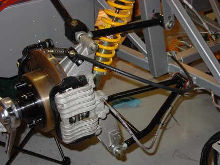

Maybe this will help, if not, let me know which part you would like to see more of.

It isn't hard, but I don't think I have pictures handy. I will say mount them on the uprights when the upright is on the car - I did the opposite and with the rotor, brake caliper, parking brake caliper the assembly is very heavy and hard to hold in place while attaching the arms.

Thanks for the quick response, but I'm still in the dark. What I need is a pictures of the parking brake caliper assambly itself. I am trying to figure out how the parts go togeather. A picture showing the mounted parking brake from a couple of close up angles would do the trick.
You need to drill and tap holes in the upright for that cable stay that Dan shows in the second picture, although later kits might have had that done for you. Think I used 1/4-20 and it did well.
