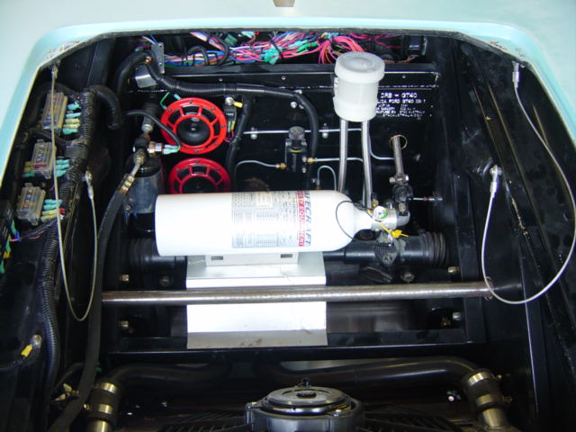

I'm installing the fire system in my GT-40 and in reading the instructions (I know, I know, reading instructions is a bad habit, but I just can't give it up!) they say to mount the cylinder horizontally (see attached pic with mount mock-up). Is there a specific reason for this? I'm assuming that there is a "dip tube" in the cylinder to pick up materials? Or does this mounting differ from Halon to Liquids?

The horizontal position enables the unit to fully exhaust itself. Halons are totally banned for all motorsport use.
Interesting that you are mounting your extinguisher so far forward. You will have very long tube runs to your main heat source problem areas so do make sure you bend carefully, clip well and fit your nozzles on properly.
Graham @ GTA RAcing.

Thanks for the reply - I wanted to mount it in the engine compartment, but with an oil accumulator already planned, the rear is simply filling up too fast. I have planned to mount nozzles in each fuel cell nacel, 1 in the passenger compartment and 1 in the engine compartment. The fuel cell nozzles will enter from the front of the nacel, so those should be short. The engine line will travel down the center of the car (with the water pipes) so it should be a very straight line. At least that's the plan for now.

I too looked at the engine compartment for mounting the bottle (bomb), but the mfg. stated that you should try to keep the bomb from being exposed to temps above 140 c - - and most areas would received (at least from radiated heat) relatively high temps from the headers! I opted away from this (even though it would have been a possible fit as I've sunk my fuel system into the nacel - but it's open for access.
The rear of the mounting bracket forms an "L" down to a cross member at the bottom of the front box. You have to cut a "U" shaped channel for the coolant pipes, but it all fits well.(confused yet?) The only issue is that you have to make one of the "legs" in the back removable in order to fit the bracket in and then re-install that leg. I'll try to take a picture from the reverse angle and post tonight when I get home. I just drilled and tapped holes into both cross members and made the mounting bracked out of .090 aluminum - simple bends.
As for nozzels, I'm planning for 1 in each fuel nacel and 3 in the engine compartment, two under the rear fglass) - one on each side of the engine and one pointing up into the cold air chamber for carb fire supression.
I will have a second extinguisher (hand held) in the drivers compartment with liquid fire suppressent as I too don't want to chance an extremely tight area with gas fire suppressent.

Peter - I've changed the mount to lower the bomb in the car and simplify the bends/assy necessary. I've PM'd you with pictures.
Ron, Was your fire system liquid or gas based? When I talked to the Mfg. of my system, he stated that you needed 2x to 3x the volume of liquid materials to do the same job as the gas based units. I asked him about 5 nozzels on the current system and he felt it would be sufficient in volumen and would last for a sufficient ammount of time - As I think that I have pleanty of nozzels in this application I did, however, get the nozzels with the lower flow volume (smaller holes) and that should give some more "time" to the discharge.
