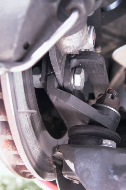

Sometime during/after the third day - which ended with the Creg-ny-Baa event, we noticed that there was a soft brake pedal - and a rubbing noise on full lock. Since we only used full lock when performing 3-point-turns and loading / unloading from the trailer, we gave it little thought at the time and figured we'd check it on return to the mainland...
On return, with an event at Goodwood looming the following week, we had a look at what was causing the 'knock-back' on the brake pads, and hence the soft brake pedal. See below.

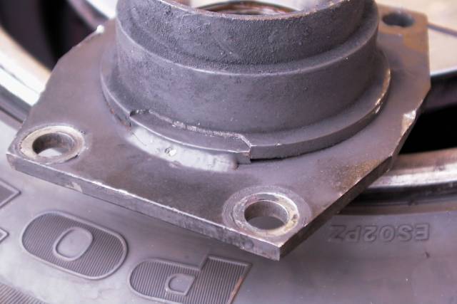

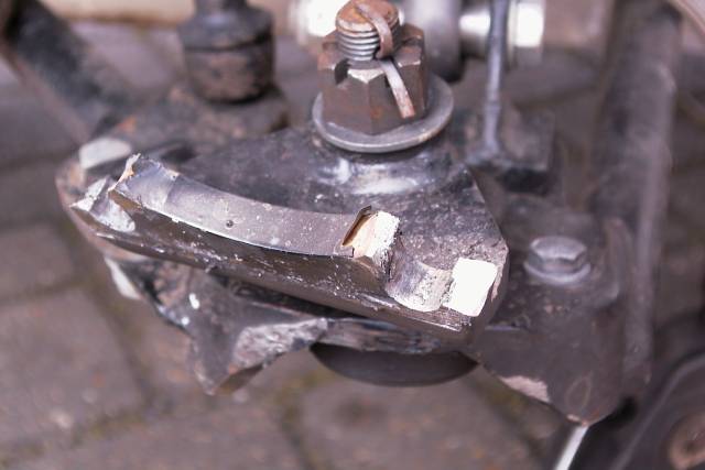

The picture above shows that the disc had been rubbing the bottom arm and the hub had developed a crack (open) where a bolt hole passed through. It had in fact cracked on both the lower bolt holes and once we dismantled the hub we were left with the following picture.
The pad knock-back should have altered us perhaps earlier but I suspect we completed the 'bumpy' Creg event with a broken bottom joint - which as we cross the finish at apporx 100mph, could have really spoilt the day!
We had pad knock back again shortly afterwards but it was caused by the other side, and this time it was the bearing support cartridge flange that had failed. The weld held good but the flange let go, again allowing the disc to run not centered in the caliper and hence the knockback.
NOTE - these were early designs that were not used elsewhere and have been subsequently replaced with better stronger items that have given no problems at all in several years hard driving. I post them to hightlight the fact that the car was trying to tell us - with the knock-back, we just did'nt initially listen to it.

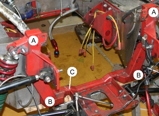

I'm a great one for checking chassis rails etc for cracks etc etc and one occasion (late 2003) I noticed a crack on the rear of Roys chassis, on the cross-member marked 'C' below. On removing the engine, we found the crack passed through three walls of the box section passing between points 'B' and 'B'. The box section was cranked and moved forward of its normal position to enable us to lower the engine and gearbox further in the chassis. On closer inspection it was noted that the welder, despite getting a good weld on the section, had been a little over zealous with a grinder and taken much of the strength out of the newly made part which subsequently partially failed.
Note that the picture below does not actually show the part that failed (don't have a pic) but shows the replacement fitted and where the failure occurred (point 'C'). It also highlights the very high loads that affect the chassis rear between points A-A and B-B. In fact many of you will have noticed that if you remove the upper cross-member (on your GTD), the upper chassis turrets do move together slightly and will generally require the chassis being lifted to allow the retaining bolts to be re-fitted. NOTE - do not leave the upper member out with engine on place (for long periods) without supporting the chassis elsewhere or a 'permanent set' may occur.
Hope this is of interest... Anyone else got anything they care to tell us about.... /ubbthreads/images/graemlins/grin.gif

Hi Paul
Nice photo its amazing just how much load those points between A-A and B-B take?
It especially demonstrates the stresses in the chassis between B-B.
You can imagine how the car might handle if that area of chassis had failed altogether.
Chris.

Also - the rear sections have been modifed several times over the years and if Roy were building again - he would not use the 'lighter' tubing in this area as he considers it an area of high stress.
Chris - IF the cracking brace I referred to above had failed completely, I guess (and it is a guess!), that it would have led initially to a 'rear-wheel-steer' condition. Something both Roy I have experienced before at varying speeds when other parts have started to 'give a little' or we have 'gone a bit too far' with susppension settings. I see the brace being generally in compression during the high load cornering we put it through when on slicks, so even a complete break would still have transferred load from side to side, although I suspect the rear suspension geometry would have been affected to some degree. On the straight during acceleration, this would I presume be in tension and hence possibly have more of an effect?? - If there are any engineers out there (on the forum) who care to comment re setup we have - please feel free to do so.

Paul,
A fundamental issue with the rear crossmember is that the members are on different planes, with lots of "nooks and crannys" This creates a staggered load path and lots of stress concentrations at each change of direction. The top suspension arm is overhung a long way from the vertical member creating a torsional load in the member. The bottom member may not necessarily be in compression when cornering. You have two loads one being the vertical load thru CL of wheel (static mass + mass transfer) the other being a horizontal load at ground line (static mass + mass transfer x coeff of friction). It is a matter of calculation to determine whether tension or compression load and depends to a large degree on the wheel CL offset to pivot points on the upright. The vertical load will induce tension, the horizontal load will induce compression. Have a look at photos of the original cars and you will note that the rear crossmember (sometimes known as the horse collar) is a single plane. You will also note that there were two tubular struts from the top inner arm pivots up to the top gearbox mounts. These take care of the torsional load issue.

Not really much of a mathematical nightmare , accurate data is the nightmare. Dynamic situation is no more difficult than static to calculate. Tyre slip angles are a bit tricky as they vary. These days I no longer hand calc this sort of thing, modern day 3D modelling software and FEA programs simplify the design process and with a greater degree of accuracy than could ever be calculated.
It is probable that should you decide to reconstruct the "horse collar" on your car some handling benefit would be gained. Your wheels will only do what they are supposed to do if the "bits" to which they are attached dont flex etc.
