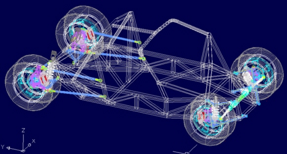

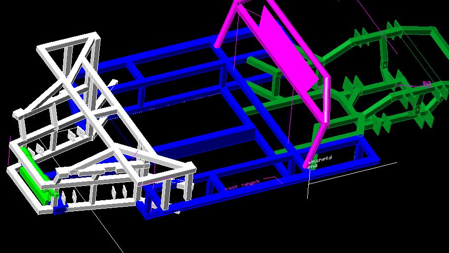

I have been kicking around an idea for quite some time now and I was wondering if it would work. All the talk about which frame is stronger recently has made me decide it is time to ask.
I want to start a co-operative frame design where I take all the cad drawings I have done for my frame and post them (I would do jpg's too for those without acad to be able to contribute ideas)free for all to see and use. The idea being that people would take them, mod them as they see fit and re-post what they have done. I know there will be alot of freeloaders and people who are not able to offer any improvements, in which case, a donation to the forum would be urged but it will all be voluntary. I have designed my car around the c5 vette suspension as trying to get a car with suspension that is not off of a road car through inspection is next to impossible, but I do have access to rough dimensions of the original suspension, (+ or - an inch).
I am not quite ready yet to post it as I have some cleaning up to do and I dont have the roll cage built as I am waiting to finish the molds and make a body first so I know that everything is right and fits.
So, am I wasting my time? Is there anyone that would contribute? Any thoughts on the idea at all?? I think in the end, if this works, collectively we could build the strongest/lightest frame that would be possible.
p.s., I know alot of you are going to say that there is more bracing needed here and here, but, keep in mind, this is not a finished drawing, by any means.

I love the idea, except I am not making a GT40 - however, we may still benefit from component drawings. For instance, I need a windscreen CAD model (in the event that I end up using a GT40 windscreen), steering rack, etc... I am using SolidWorks - what are you using?
I am using ACAD, I'm no expert but is it not possible for the 2 to save as a dxf file and share?? As for stuff like windsheilds and the like, I have zero ability to do compound curves, that stuff you need to find elsewhere.
Obviously, if we do this, it has to be all our ideas, no "well XXXX manufacturer does this so lets do that". It all should be our own thoughts or it just defeats the purpose.

The rear suspension is unequal upper/lower A arms with a tie rod end also (very easy to do rear wheel steer if I wanted).

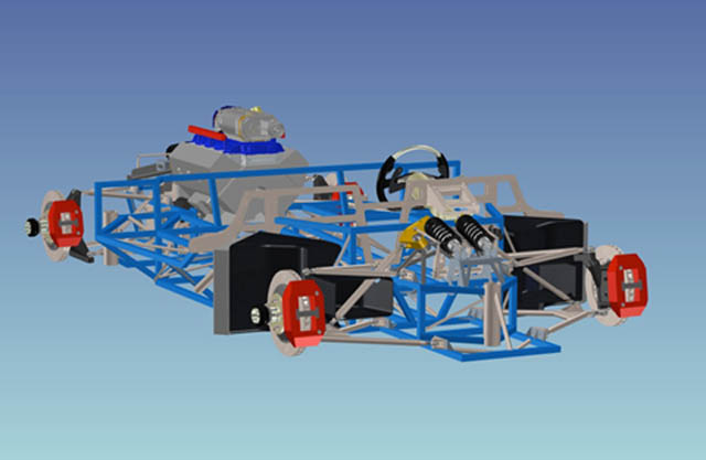

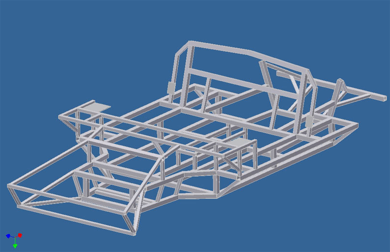

Below is an image of a chassis as posted on their web site from CARBONTECH.

Nice design - at least what I can see. I'm curious why they chose to go with the pushrod/bellcrank/midline coilovers - kind of seems like bling to me, at least on the front - unless they're trying to unload sprung weight.
Pretty designs, but a lot of work if it's JUST for show. And you've got to stuff a radiator in there somewhere too. Now if it's for a formula car, well then that would make a bit more sense...
In racing, time is everything when it comes to testing. Putting the dampers / springs in one spot where you can quickly and easily get to them both (and the sway bar) saves lots of time. Also, it's an effort at descreasing unsprung weight.

Eric,
I like the drawings you posted! I have to say that I thought your VW dimensioned chassis was nice, but a little over built perhaps. I think you are definitely headed in the right direction.
As you all can, no doubt, tell, Eric is not a newbie at this. I think his talents will be valuable here at GT40s.com!
Lynn

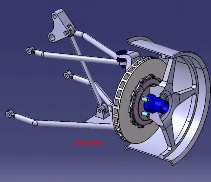

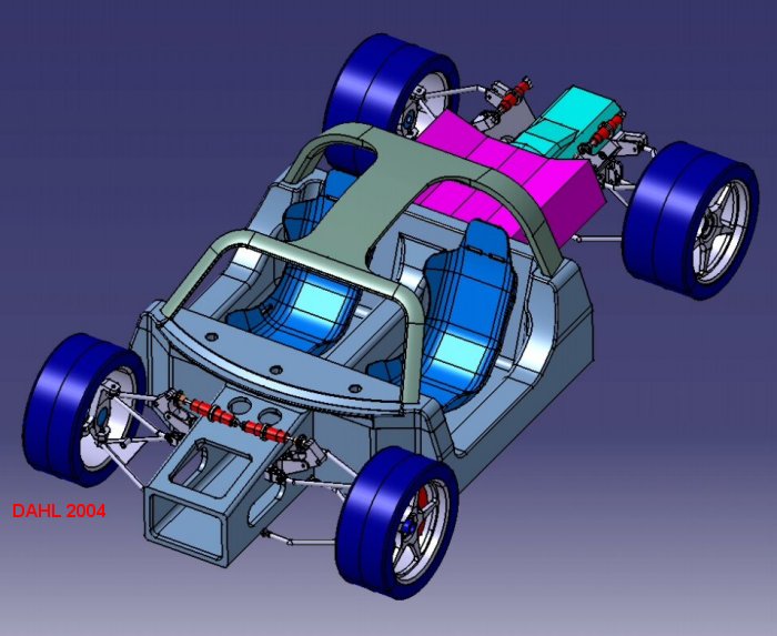

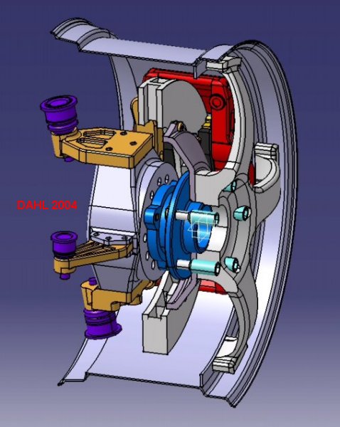

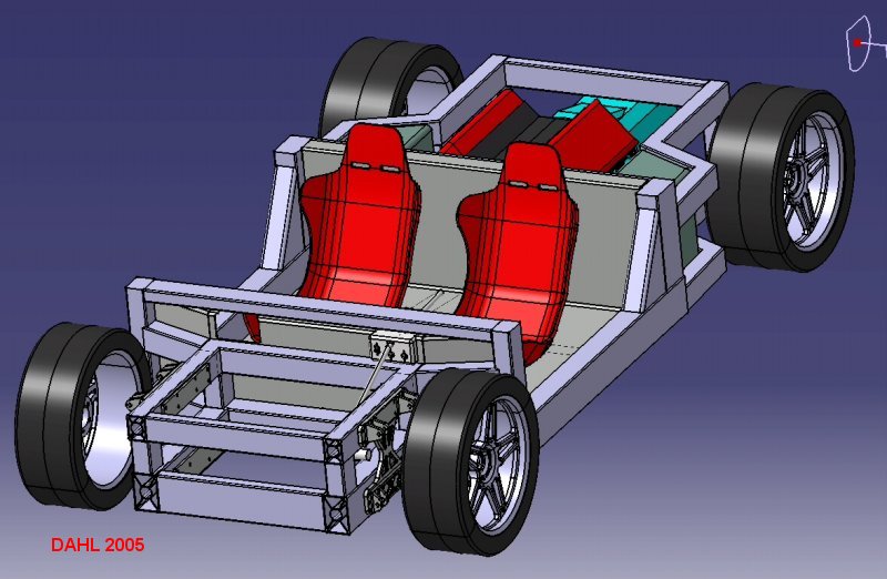

Hiya gents,
I have done alot of chassis design/development work. I have designed with carbon, aluminum, and steel.
I am using Catia V5. Maybe I can help. I have a great deal of packaging and stress/loading functionality experience for chassis and vehicle dynamics.
I include some images of past work. Let me know how we might proceed with this. It could be an interesting project.
