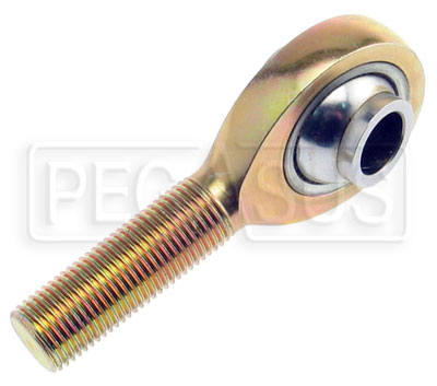

Usually the joint may not have enough bump travel as the upper arm typically has ~10 deg slope on it at static ride height. Then you add another 10 degrees in bump and you exceed the maximum of 18 degrees. I guess you could slope up the bolts ~10 degrees to center the joint at the static point.
Depending on your wheel travel, angle constraints might be a problem. You should use this type of joint or small-diameter spacers on either side of the joint. This joint allows a total of 76 degrees motion (1/2" - 5/8" size).
