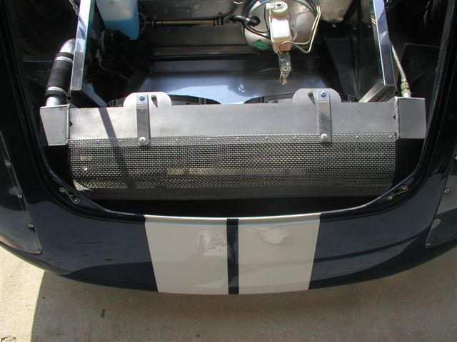

Here is what I ended up doing for the radiator screen. It's stainless with a large bow in it to allow more air and let plastis bags and other FOD move around it.
Re: Some solutions I\'ve found
Veek, that stainless mesh screen is a great idea. I wonder how much it interferes with the air flow.
I've got ugly air con condensor and some messy plumbing/wiring in front of my clip and have seriously thought about a mesh. Mounting it further back off the front of radiator/condensor is a attractive option. Mesh right out in the front of the nose, wouldn't work for me, so now I have another option to think about...thanks. Oh, I hope you don't mind me stealing your idea.
Also great to see the front clip painted.

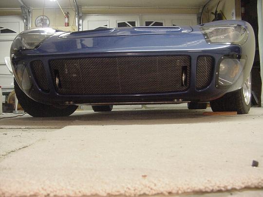

Craig,
I made up stainless panels for all of the holes on my car (radiator, brake vents, induction holes, side scoops, rear clip), and never noticed any change at all in running temps. My panels are all glued directly to the glass, using split 1/4" vacuum hose as gaskets.
