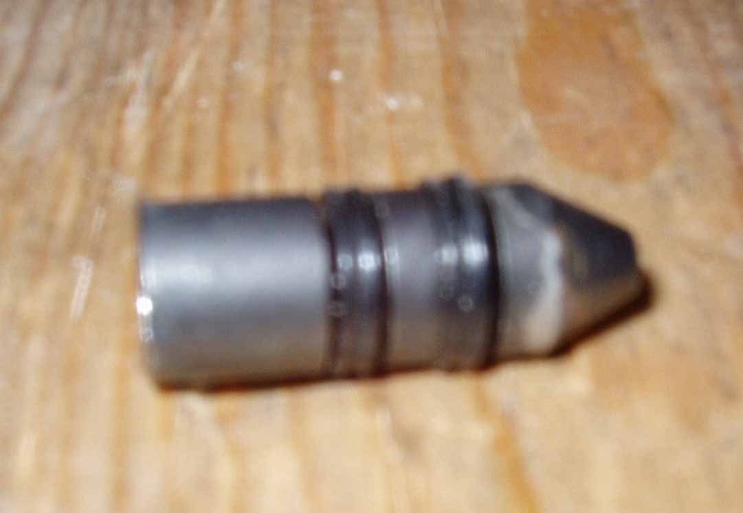

I'm pretty sure I've sussed it.
I rebuilt the servos using all new parts and changed the fluid from silicon (dot 5) to non silicon (dot 5.1) but didn't realise I'd missed out on replacing the two small rubbers on the non return valve in the servo.
As everything else was new/reconditioned there's not a problem with the system as a whole, but these seals have swollen and are causing the valves to stick in the bores.
New seals on the way, so should be sorted soon.
Simon
Here's a (pretty poor quality) picture of the offending part.
You can just about make out that the top seal is slightly bigger than it should be.
Simon

If the change of fluid type has caused the problem (?) then are other seals in the system also at risk - most notably the piston seals on the calipers - or are these all new.
I know you need to empty and ideally flush out any system when you change the type of oil (e.g. mineral to synthetic) but I didn't realise it would have this effect.
Dave,
Evey other seal in the system is new and has only been exposed to dot 5.1 fluid.
I spoke to a specialist today, a chap called paul norton. What he doesn't know about servo's isn't worth knowing.
He told me that this can occasionally happen as the two types of fluid have different "swelling" properties. He also said it's very rare and that he has been using both fluids in his cars for some time with no ill effects.
Got some new seals on the way.
