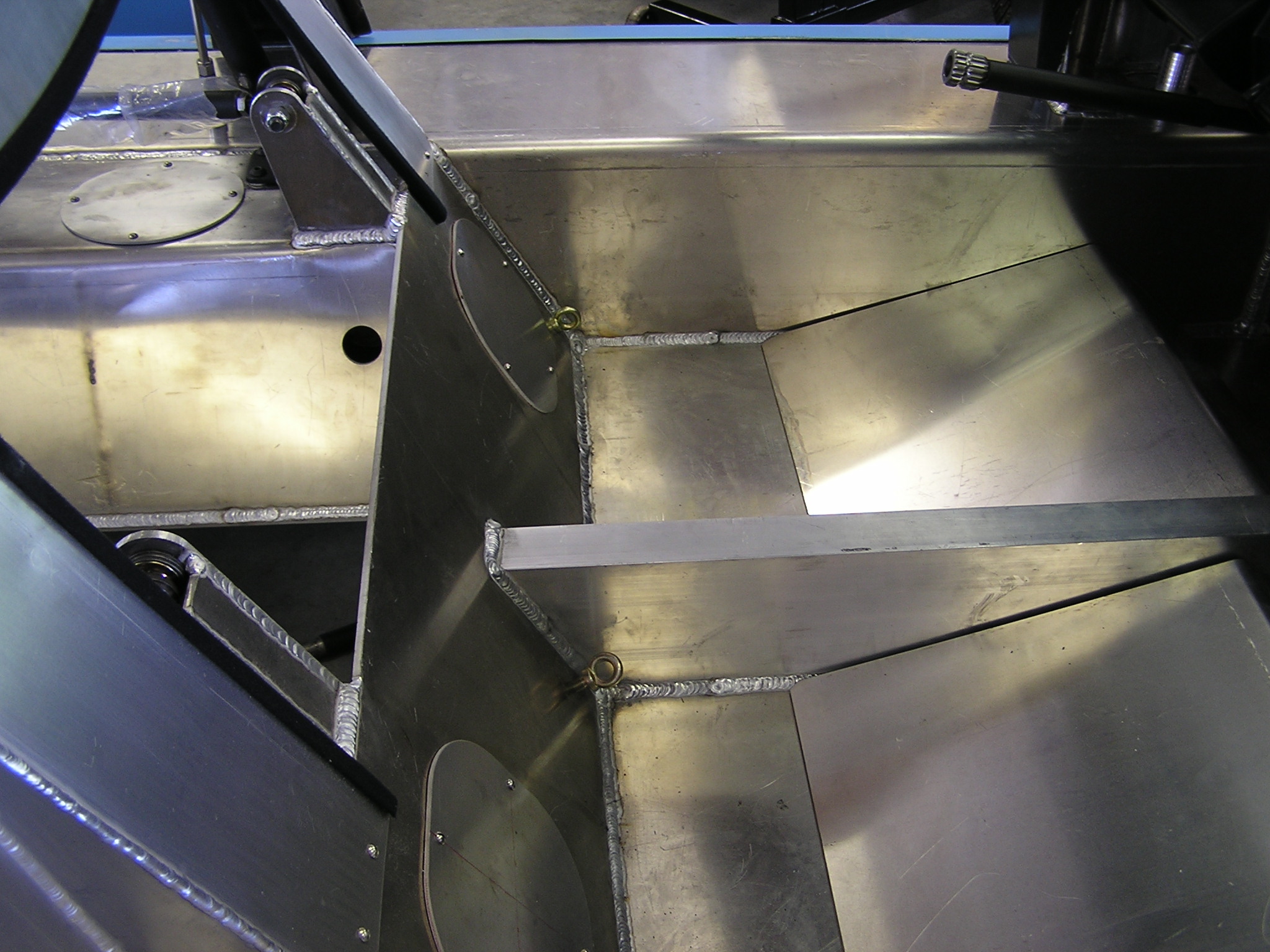

Great pics Mike. I plan on building one of Fran's MKI GT40 kits and I have a few questions:
Where do the seat belts attach?
Can you enclose the front section behind the radiator?
Bill D
Fran Hall RCR
GT40s Sponsor
Bill.
the belts atach through the rear bulkhead to the roll hoop cross brace and also into threaded bosses welded to the seat back support.The eye bolts are included and attached before shipping..
The rad support can be panelled as per original....did you expect anything less.... /ubbthreads/images/graemlins/grin.gif
