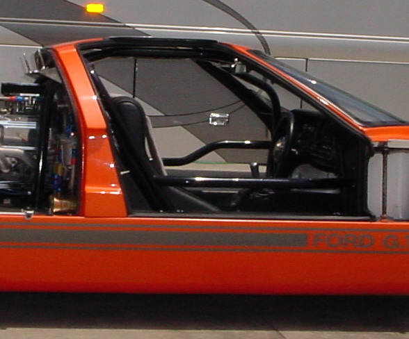

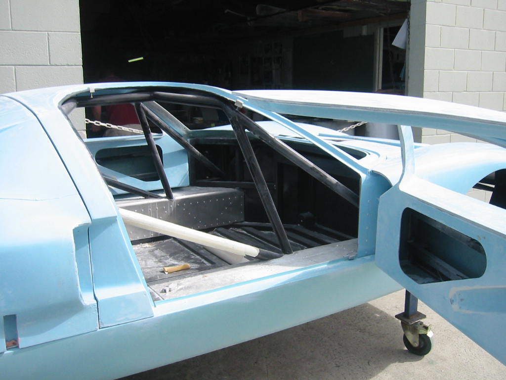

Not the RF cage, but here is how the DRB roll cage is fitted in the door area. Leaves quite a neat space for getting in and out with the bar to sit on and bars to hang from.

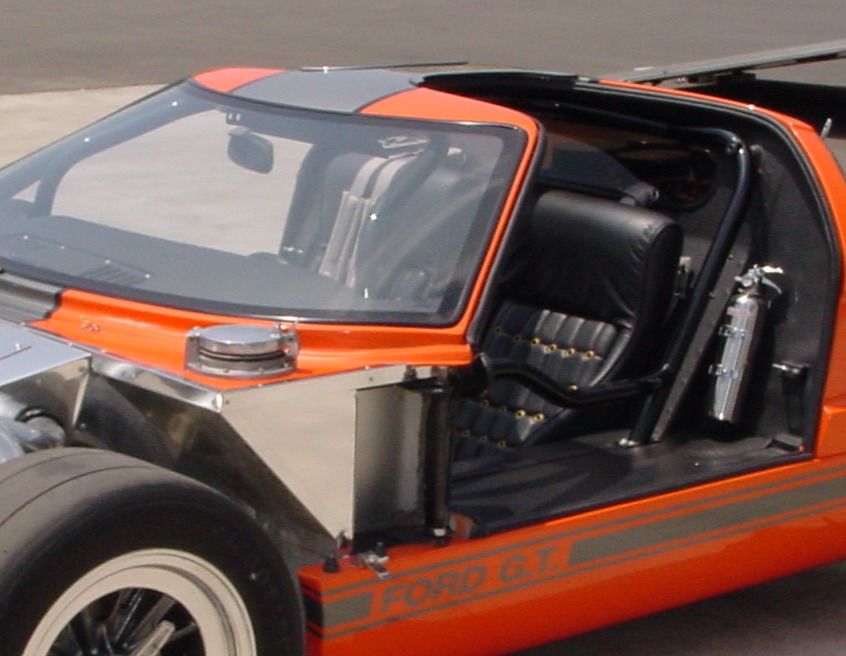

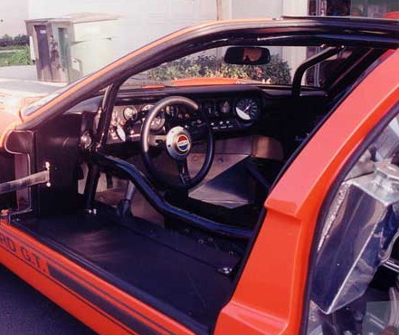

Here are a few pictures of the full cage in my car.
I dont have a shot of the cage under the spider but all I can say is it is a work of art.

Richard, the silver powdercoated frame looks really cool with the aluminum panels. This is the first pic i've seen with this option.
Even with the full cage it looks like you can just step in, and kind of slide into the seat. Time for a snack /ubbthreads/images/graemlins/smile.gif

Alex, The silver that was used on Rich's GT is no longer available as it had adhesion problems and it would crack with bolt stress. We tried several methods and they all failed so we decided that it would be best not to offer it.
Rich's chassis was recoated here in the States, I believe.
Also Rich has the eight point cage. The six does not have the down tube that is located in the door opening.
Thanks for the clarification Hershal, I was not a fan of that down tube. If I get that restrictive to entry I'm going to do something more safe such as a triangulated bar - it'd be hell in and out but offer more for protetion, however, it might be impossible to fit something that complex in there. The six point will be fine for NASA and Club track days. Ron
Ron,
It’s not really any harder to get in or out of. As you stand on the seat and slid down in anyway. Getting out you pull yourself up and stand on the seat to get out. Think about it you don’t get in or out of these cars through the side of the door you get in from the top. Well at least that is how I have always done it.

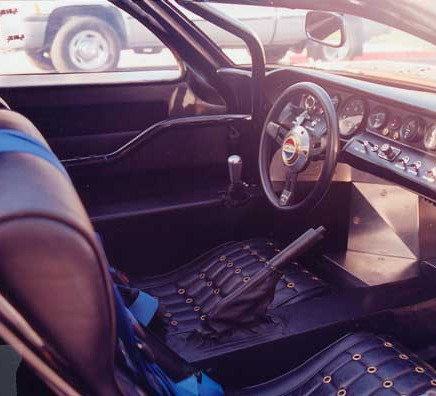

Believe or not, it's easier to get out with the roll cage installed. Just like Richard says, you position your hand above your head and pull your body up rather than push down using you shoulder is something of an awkward position. I have a bad rotator cuff and without the roll cage it would be painful to exit my gt40 without the roll cage /ubbthreads/images/graemlins/crazy.gif /ubbthreads/images/graemlins/cool.gif
Tim Kay

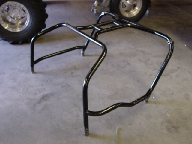

2nd. (You will notice a 'dog leg' bend on the driver side to allow for my left hand shift lever)

Here's one more (last one, I swear /ubbthreads/images/graemlins/wink.gif)
