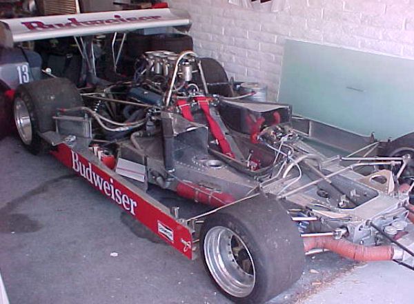

My big questions are:
1, Big fat Avon slicks are sticky. Too sticky for this floor ?
2, Can it be applied over a previous coating and still work ? The previous coating is a clear epoxy (Behr) over a bonder primer.
Your floor looks GREAT!
