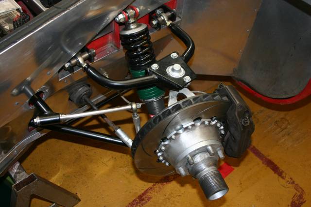

The next club mag is due out in Sept (BEFORE AGM in OCT)... so I would need the copy by about Sept 10th if poss...
ps - Your top arms will be fine I'm sure but IF you consider replacing them, also consider Roy's latest version that also directly replaces top arm and is fully adjustable.
Speak soon - Paul...

Agree with what Roy said. However because I have cut and welded my suspension arms a lot over the years, I have just bought a set of Roy's arms and am pleased with them. I was keen to get the non symetrical set as it gives me more ability to play with castor. I also chose Roy's option to have heim joints on the upper arms so I can play with camber more easily too but I know Roy can supply with the tubes for rubber or nylon bushes to be the same as the standard GTD fittings.
Looking at the picture Paul posted above, I also think Roy now does these arms in straight tubing as opposed to curved tubing, but check first.
