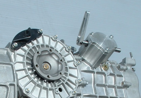

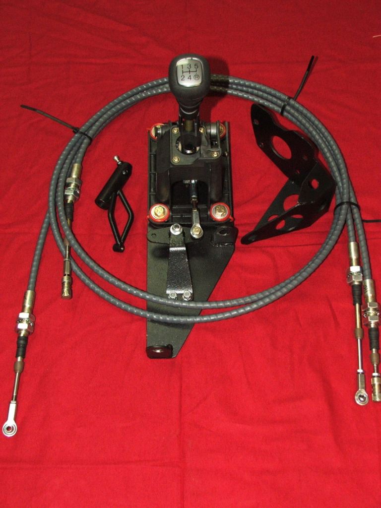

I was speaking with Renegade a couple of weeks ago. They have changed their cable system recently from the one supplied also by Patrick and Powerhouse II to a different one which connects to the side shifter Lynn mentioned. They no longer supply the one supplied by Patrick and Powerhouse II which connects to the rear rod. Here is a picture of the new one supplied by Renegade.

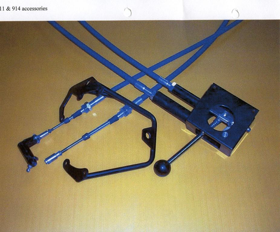

Here is a picture of the one supplied by Patrick and Powerhouse II. This picture is a couple of years old, so it may have been developed since then. This is the one for 930 normal (Porsche) way up. They also do a very similar one for G50 inverted. I don't have any photos of it. If anyone has please can you send me them.

Not sure about what KEP can offer, and I'm afraid I haven't had a price from Renegade, but it looks like an expensive kit. As Lynn said the side shifter is probably brought in, from CMS (see Tim's post click here )
I have attached a photo Renegade sent me of it.
Anyone got photos of the Powerhouse II, Patrick, old Renegade setup?

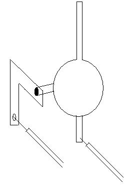

Does anyone have a close up picture of the shift lever using two cables, similar to the picture Lee posted above by Powerhouse II.
I surely understand the fore & aft throw but how does the cable control the side to side throw at the lever. Keeping in mind it is mounted in limited space on the frame, next to the gas tank (not the center tunnel \ left hand drive - left hand shift).
Once I understand how the cable is manipulated at the lever, the attached end at the tranny is easy.

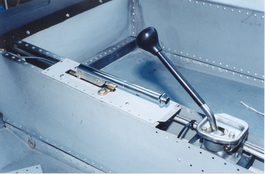

Here are a couple of pic's of perhaps the simplest cable shifter I have ever run across.
Andy

Sorry, hit the send button too soon..........
Andy
  • 64355-SandShifter.doc

Here is a very quick, very simplified drawing to illustrate one way the side to side motion gets translated in the shifter. This is how the Toyota shifter that I use does it. The side to side motion of the shifter causes an arm to move in an up and down plane. This is translated through a bell crank to a fore and aft motion which is transmitted by the cable to the back of the transaxle.

I have a shifter that came from a mid-late 80's Toyota MR2 that looks very similar to the one in the first photo.The cables would be too short, but the shifter is a very nice little unit.Cheap and fairly plentiful. I'm going to use it in my mid-engined Corvair. Cheers, Dave

Dave,
What we did is buy the shifter with the cables. Then we cut the hard parts off of the stock cables and welded them to steel rod which was then drilled and tapped to accept Morse stainless steel control cables of the proper length.

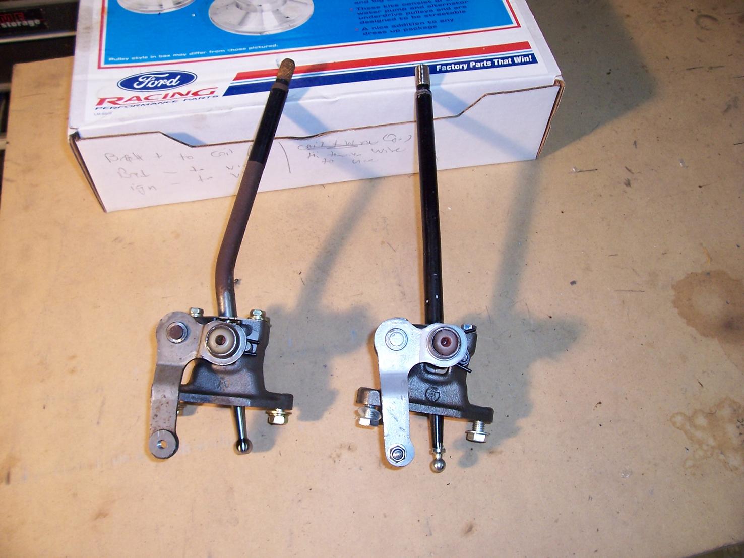

Not sure which Toyota this came out of...I assume if you
compare pictures a Tercel or Corolla shifter it might
become more apparent. As Lynn says...they're pretty simple
devices once you look closely.

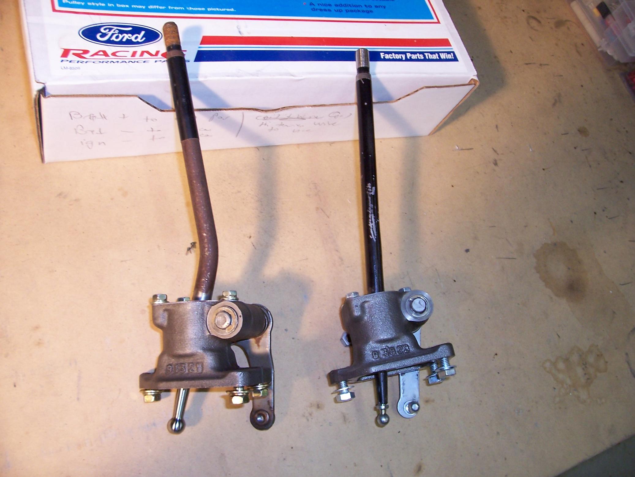

Here's a stock Toyota shifter and one from CAV (?).
In addition to straightening the handle (?)..looks like the bottom ball was cutoff and shaft threaded for a Morse cable
MikeD
Picture of the other side.
Looks like Neal uses the same shifter.
It appears you can use Morse cables with either
Heim ends or ball/socket ends.
MikeD
