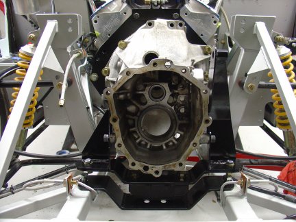

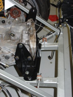

I spoke with Robert last night (my time), and I think I have the gearbox mount configured correctly, but would like a second opinion. I suppose I should add that it is the Audi 016 3U box using all the supplied RF hardware. I think I will have to mill out some of the mounting holes as it looks like my assembly sits just a tad forward. It also appears slightly cocked right to left, but that should be very minor.

That looks right for a stock piece Pat. But, I think you can actually do better by leaving out the lower mount, ditching the rubber block, and simply bolting down both top ears to the chassis with some small bushings. What this does is tilts the engine back toward level (in your configuration you'll find the engine tilted forward) and lowers the tranny backside about 1.5", and simplifies things. I'm pretty sure Hershals is like that and it works fine and looks better than the stock setup. He might have some pictures.
Ron

Ron, I like your idea of eliminating the lower mount. I wasn't overly keen on the way the engine leaned forward; dropping the lower trans mount would solve that while still allowing the transmission to clear the crossbrace.
I was considering making this exact change but if you remove the lower mount and rubber block, you will need to check clearance with the cross member that sits just under the gearbox at its fwd end (near the adaptor plate that mates to the motor). I think from memory this will need modification as well to allow the box to lower.

Regarding the gearbox, as my assembly sits about 3/4" to 1" forward of where the frame holes are located, I have quite a bit of oblonging to do. May be best to weld on an ear to the mount plate and drill a nice hole. Any idea on where to source the urethane blocks?

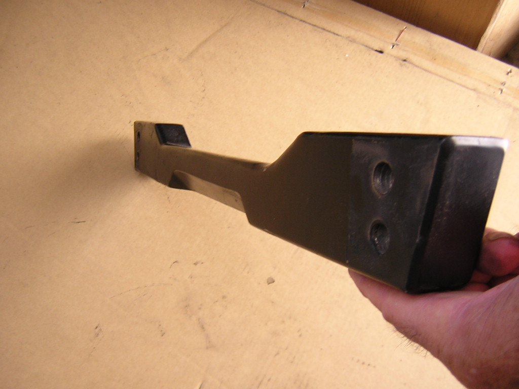

This is the crossbar mod I did to mine so that the header pipes don't hit when the rear is lowered.

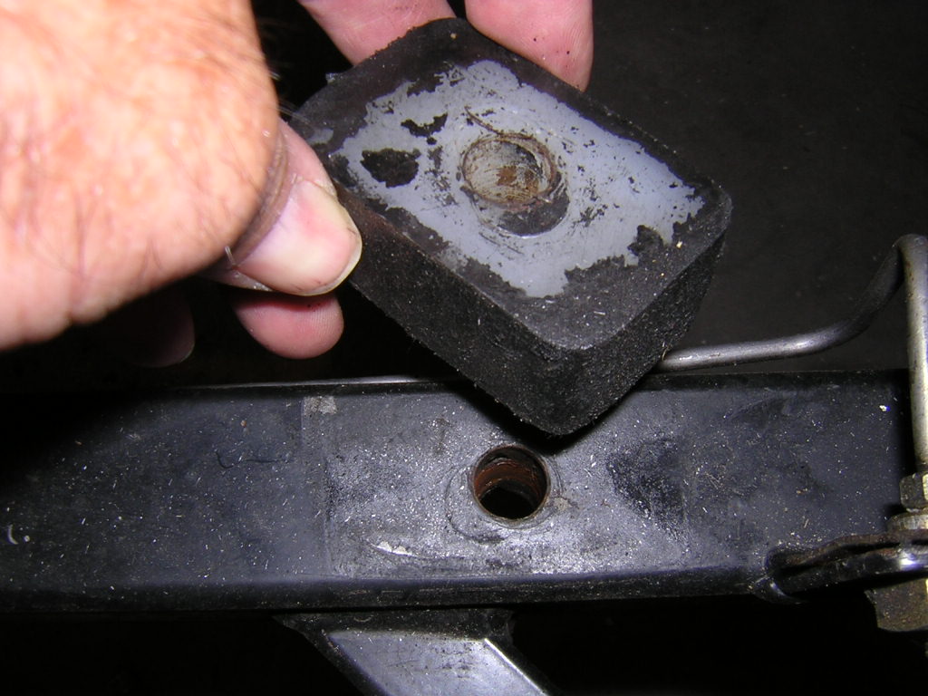

Here is the poly block and the hole that's already in the frame.
Hersh /ubbthreads/images/graemlins/smile.gif

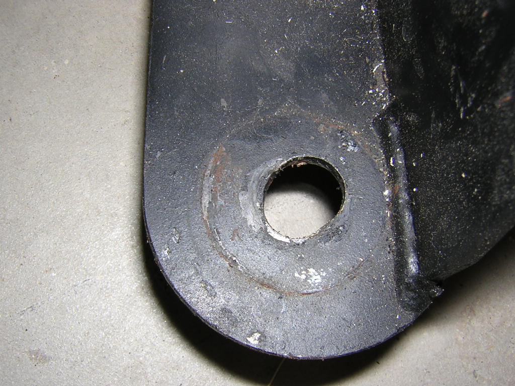

This is the hole on the trans bracket that was oblonged.

Dan, the legs of the gearbox mount mate up fine, it's just that everything sits forward of the holes in the frame rail. Not sure why, but before I do any modifications I need to get the box back from my gearbox guru to double check everything.
