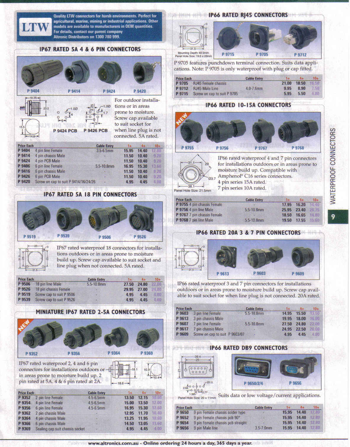

Lynn
Found this page in a catalog from one of my suppliers.Weatherproof screw cap for when not using and 5A rating.I can get them and send them over if you like,doesn't cost much and those switches I sent to Tim arrived within a week.Let me know.
Ross

Thanks guys! I ordered the Switchcraft 2 pin female panel mount, the matching 2 pin male cord mount and a protective cap from mouser. (Part nos. EN3P2F, EN3C2M and EN3CAP with a UPS ground shipped price of ~$15.00) These appear to be very similar to the connectors you showed, Ross, so either would work equally well I am sure.
