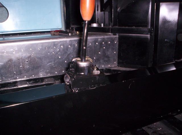

I have the Corolla cable shifter in my DRB GT40 and all seems to work OK.
