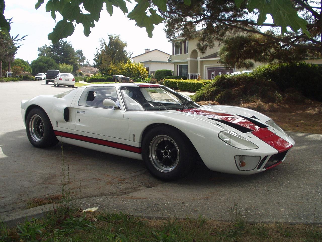

hers a picture with the Vitaloni California Mirror mounted and painted on my car.

Chris,

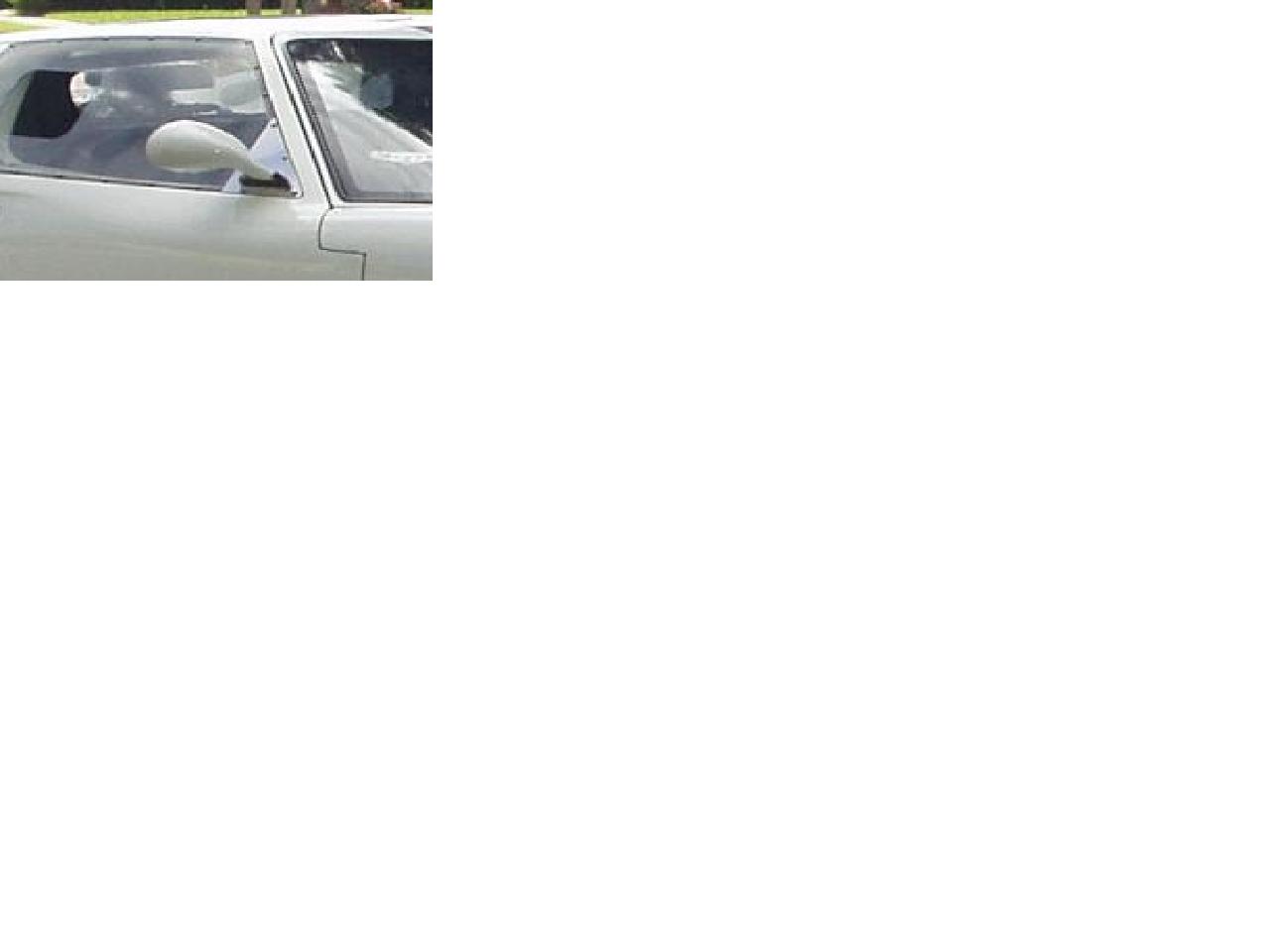

Very nice, any chance of getting a closer picture of how you have mounted the mirror to the corner section of the window. That's something I have been considering for some time now.
Is the mirror mounted to the plexiglass, is there a plate for reinforcement over the plexiglass and/or is the plexiglass cut back?
Tim, I think you can download the attachment and zoom in to seee a stainless stell plate attached to the window on the outside, screws through both into the door frame. I'll try to do it from here.

Thanks Chris, that helps. Another question - Is the stainless plate laid over the plexiglass or is the plexiglass cut back? If cut back, how is the plexiglass secured to the plate?
Thanks to kevinc, I ordered a set of mirrors today from Pegasus at a discount.
Tim, the stainless plate is on top of the side window, I have to note that the passenger side mirror is put to a fairly high angle for the driver to make use of with this arrangement, but the mirrors do look good. Hope that helps.
