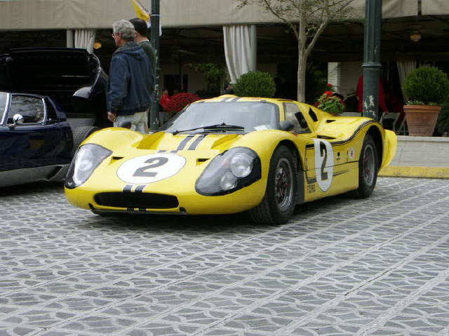

Jim, I don't understand the first sentence of your reply. What does "Yellow fire dots alum. Red Fiberglass" mean? Where the cars marked with different color dots to denote what materials the bodies were made from? Thanks Gregg
At Le Mans to let the marshalls know what the car is made of so they can use the right fire extinguishers. Small red and yellow circles painted on the fenders and center sections.
Now here's a bit of trivia. Why are the fire dots on J6's roof orange?
Did someone try to remove the red dots with pain thinner...
changing the shade to orange?
