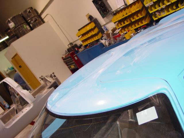

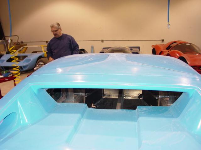

A couple of pics of the fit of the RCR40 doors
Fran, super nice fit on the doors ,thanks for posting the pics. I will strive to get mine to fit as good as that, it makes me more convinced to purchase the Gulf flares for my GT . Soon. Kevin
