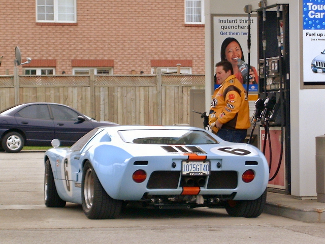

Oh yeah, this is Angelo, still putting gas in:)

Ian - love the pump shot - that's not Regular is see Angelo filling in with (install a Gulp-Gauge?).
