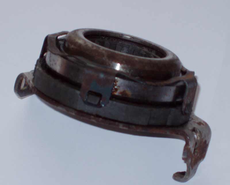

Does this look like a standard Renault item?

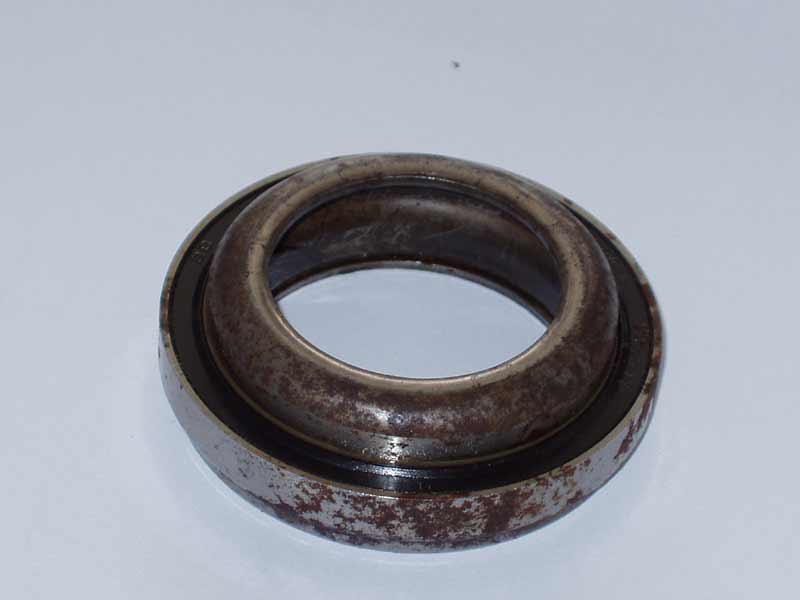

Here is another picture

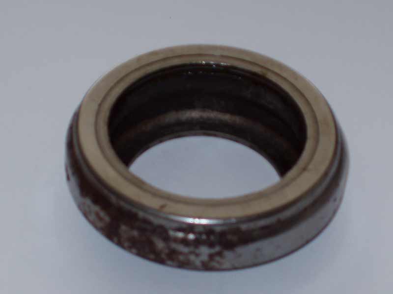

Does this look like a Renault 21 Turbo item?
Brian Magee
Be wary of the nylon part. These can overheat and melt. Both Frank Catt and Chris Cole (Mach 1 Transmissions) can supply steel replacements.
Brian.
