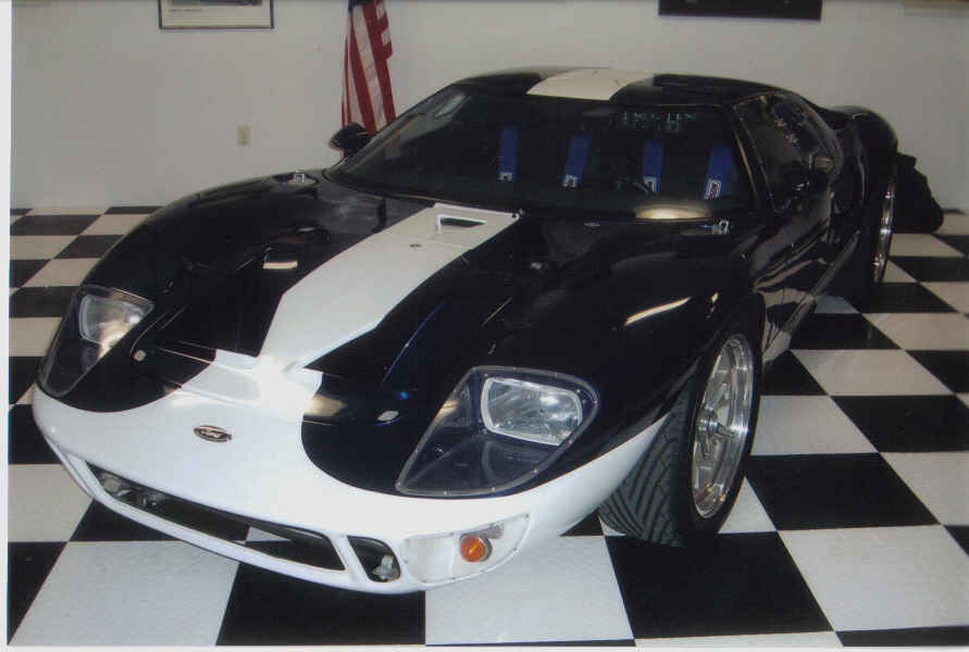

The GT40 is on the road after extensive rebuild.
Will be at Athens this Saturday, rain willing.
Some items are;

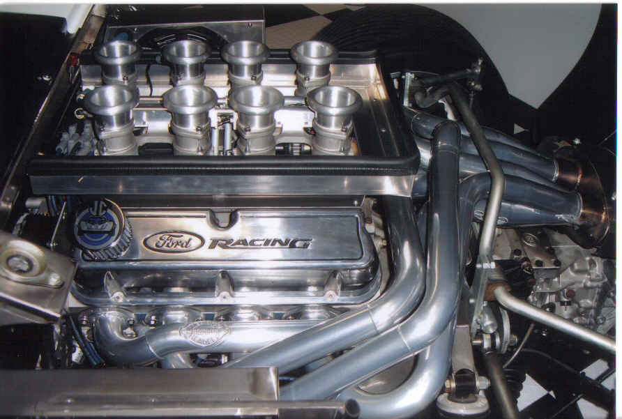

Dart aluminum engine block with SCAT ultralight crankshaft,
SCAT conn rods, H-beam,
J&E pistons AFR aluminum heads, aluminum flywheel and fuel injected.

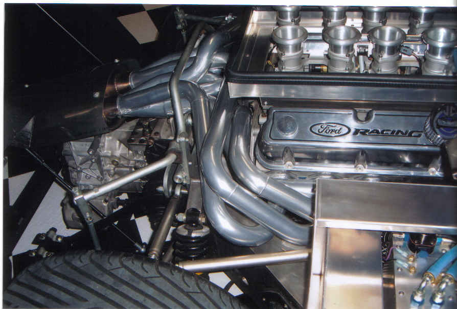

Ceramic header coating.
New stub axles and drive flanges.
New drive shafts and CV joints.
Improved A/C and cooling.
Complete heat shielding of cockpit, Dynamat,
caulking all joints and double
plexiglass rear window.
Engine and chassis dyno run and tuned.
Runs 550 H.P and 547 lbs-ft at 3,000 rpm.
I will post photos
John
