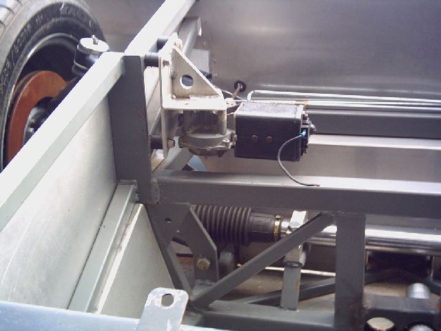

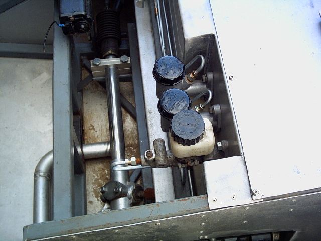

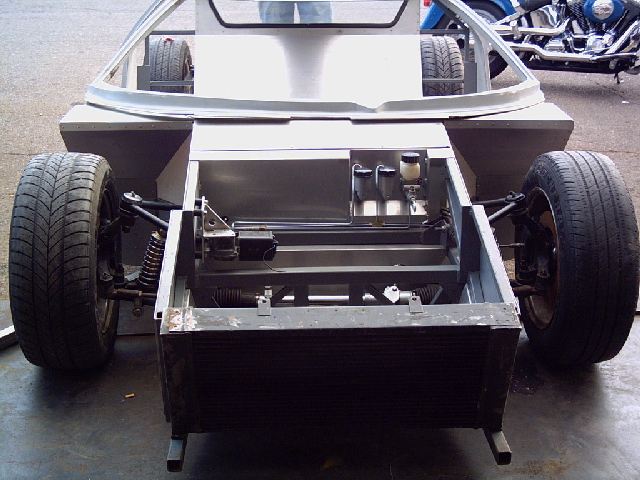

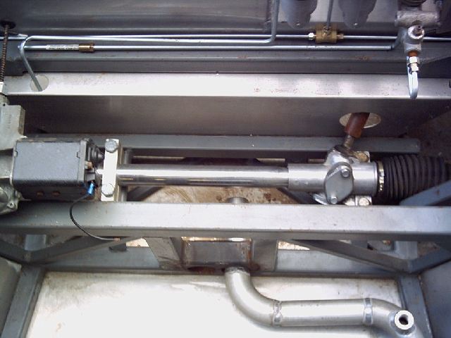

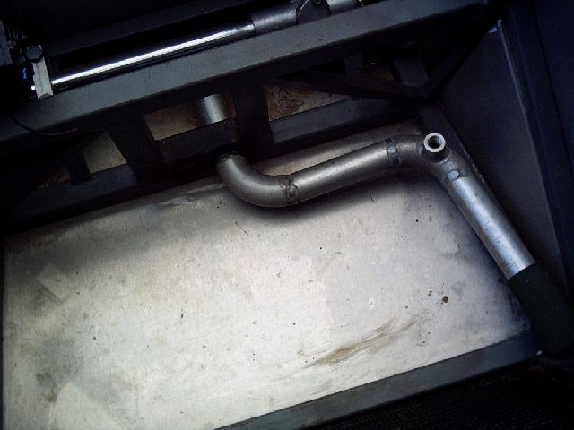

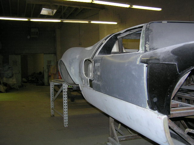

Finally we started popping some pieces from the molds, have everything in hand except the rear decklid...its fully prepped and ready for the mold. Meanwhile I am concentrating on the brake piping, cooling tubes, and then the electrical. I will post more as I make progress.

Thanks Mark...Trying to do a little each day and keep the momentum. I will post more Photos as I make progress.
Phil
Bill, Thanks so much...your build looks good also, I checked out your build site. I apprecialte the support. I have been at this project for a while now and sometimes I think I will never see it finished...But its a GT40, and it must live!
One thing I can tell you is that I have never lost the passion for this car. I can tell you that I cut bend form and weld all types of materials all day, and it can get boring, but I always look forward to doing a little bit on the GT, that is my relaxation time.
Frank...I think you are referring to my front uprights. They are Mustang, The upper wishbone is an off-the-shelf tubular Item, the lower wishbones I fabricated. I am using 12" rotors with Wilwood 4 piston calipers. Those tires are temporary items. I apologize for the dust and dirt you see on the car as we had a small water problem and its been tough to clean up, I would have liked it to have been in a little better appearance before the photos, but I started snapping and here we are. Thanks for your support also. If you need more info on the front end PM me and I will give you some specifics.
Cheers to you both
Phil

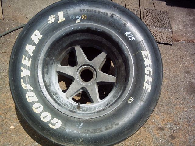

Went to a friends shop to look over a job and fell in love....Just couldn't say no to this deal, Sizing is 15 X 14 rears, and 15 X10 fronts, almost perfect backspacing, Just need to make the fit-up. These are from an '84 March champ car chassis, magnesuim..super lightweight, I will post more photos when I get my hands on them, remove tires and clean them up.
