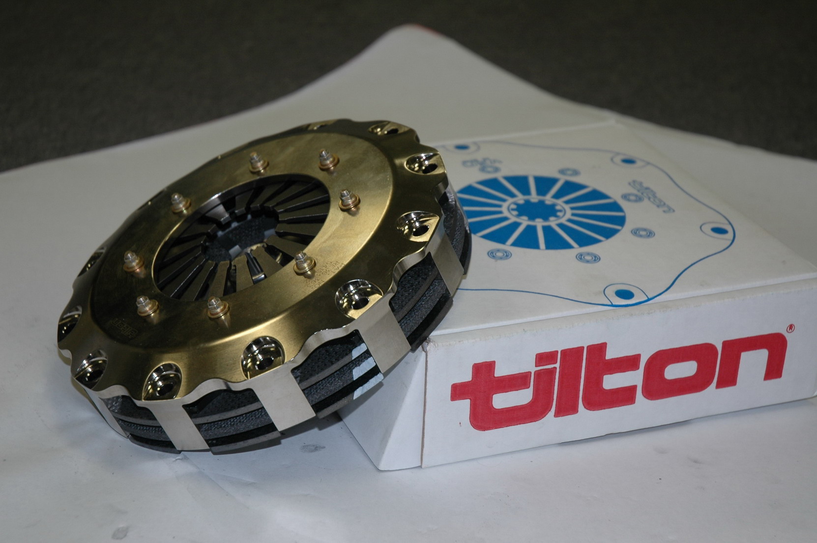

No, but here's an option for Windsor\G50:
11# flywheel, Tilton carbon\carbon with a concentric hydraulic throwout bearing /ubbthreads/images/graemlins/shocked.gif

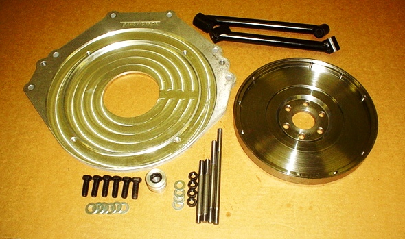

For a Windsor to G50, this is all we use--good for 600hp just balance the flywheel etc and uses the porsche clutch,ringgear,starter bolt up and go
