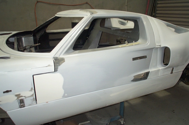

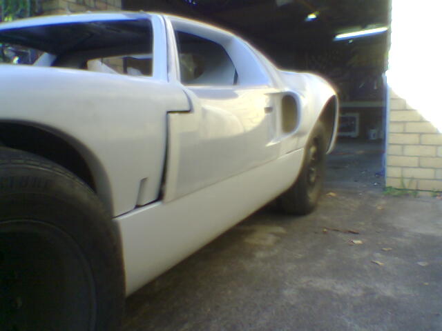

Started fitting body work today.
Got the spider in place
Sills in place temp.
front clip mounted, all the gaps seem fairly reasonable at this point.
The questions are the gap between the sill & front clip seems pritty good but should I be able to see the chassis tube that the radiator is suported by. it is down by the width of the tube 20mm.
If this is ok then that is good.
If not I will drop the front of the clip but it may not help with the gaps.
2nd question .Doors seem to be a good fit around the roof & front pillar.
At the rear pillar the door hits & wont fit in the apature it gets wider maybe 15mm overlap towards the bottom.
The rear leg is in the exact spot & no I havnt fitted the rear clip to check but I will.
If that all works out & the excess has to come of the door is this amount normal.
If it is then that ok but does anyone have an expected measurement for the lenght of the door & from the back edge of the door to the door handle recess to give me an idea if im going in the right direction.
I dont want to cut the doors then find out it was a bad move.
I presume I was correct in notching out the underside of the sill to accomadate the lowered floor.
As the sill has to stretch a long way & it didnt look right.
Nothing in the manual ,I presume not updated .
The other thing is the front clip lower edges seem to wont to keep curling intowards the body. is this normal & I presume that once it is held in position on clips & cones it will eventually find its relaxed position ?.
Hope someone can help with this.
I will thank you now. Jim Cowden

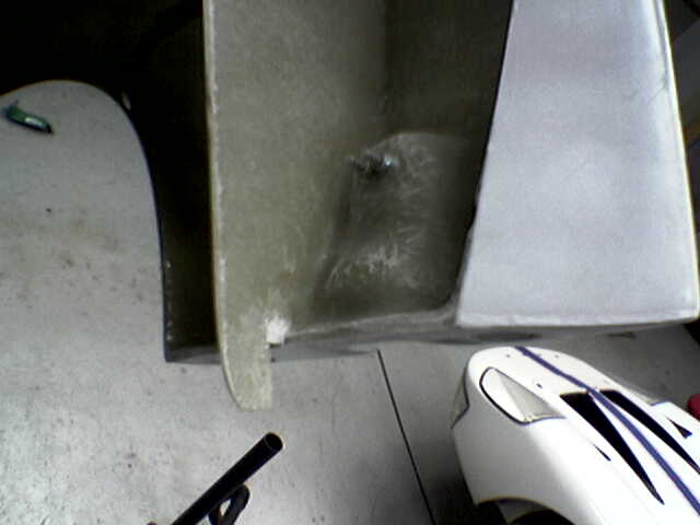

Is this what you mean by front clip curls in where it meets the door/sills? (see below)
There is a stiffener piece out of fibreglass that is glassed in to push it out to the correct location. Standard on new bodies, not on mine (or yours?) I'll add that photo too.
Bill.

Nice work to help that problem out Bill. I know others have dealt with it using the locating cones, but then the body can flex back in when raised.

I know that I fitted the back legs of the spider first, as per the manual. After that, I made many measurements with the front of the spider, trying to triangulate to different points in case some of the frame bracing didn't coincide with the centreline of the car. You have to remember that the original moulds were allegedly taken off a damaged then repaired original vehicle, so in effect we are all living with the original panel beaters work /ubbthreads/images/graemlins/banghead.gif
If you check out some of the photos on my build, you'll see in which areas I had the most problems. I recall cutting quite a bit out of the leading edge of the left door and there was also a bit of material that came out of both A pillars. My left door was bigger than my right door and it didn't matter how much manipulation the spider received, the door wouldn't fit. I also remember taking material off the bottom edge of the right door..... Probably sounds different to what other RF owners have experienced.
Check out the RF photos in the build pages and see where work was done.
As far as the photos above are concerned, they are provided by RF as an option and help keep water out of the doors/cabin if you are caught in the rain.
Hope this helps
Bill.
