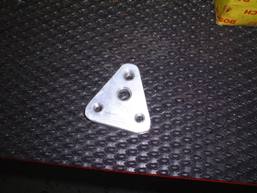

I have taken a pic of the lower hinge plate I made.
I also made them for the upper hinges & rear spider legs.
I taped m8 threads into 10mm alloy plate.
I went to M8 bolts to give enough scope to move them around ,the hole in the middle is 10mm.

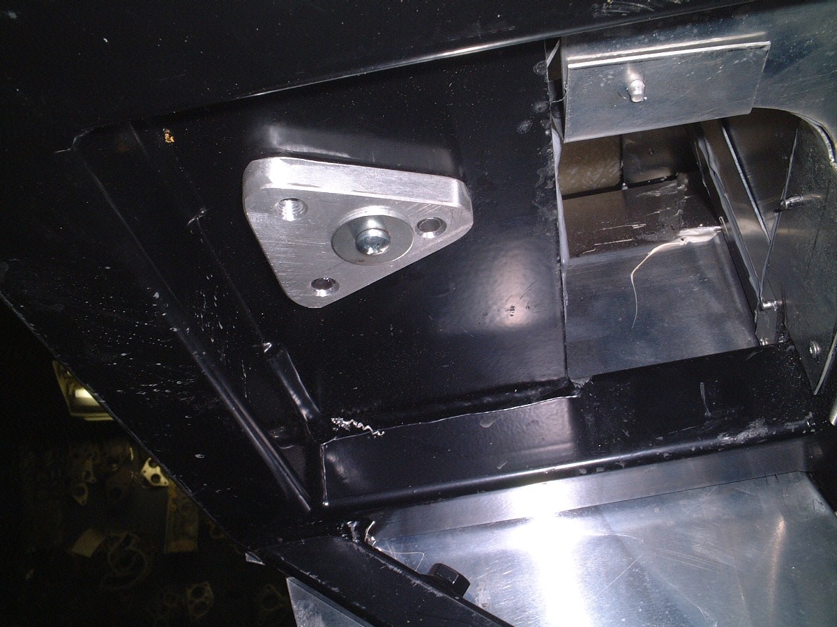

I drilled & taped an m5 into the frame in the centre of the 10mm hole & fitted a screw with a large washer & locktite it in the frame but left the screw loose enough for the plate to move around for adjustment.
When you take the bolts out the plates stay there because the m5 screw & washer holds it up.
Hope it helps.
