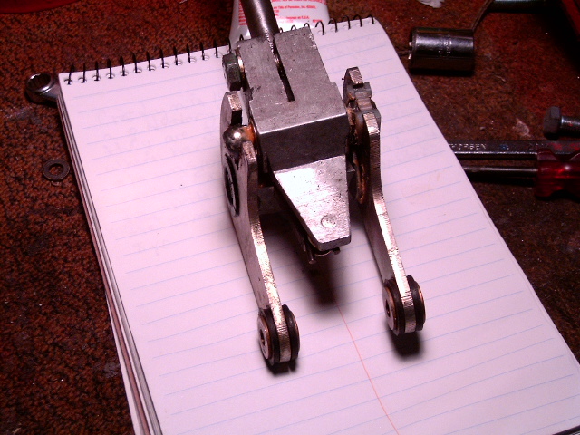

I need a source for the little plastic ball joint holders that are part of the shifter mechanism used on GTDs. I mean the shift lever at the front of the car that you shift with your hand. There are two on each shifter. They control movement of the two shifter arms by slipping over the balls that are part of the two arms that the cables are attached to.
1. For the record what car is this shifter out of.
2. I NEED at least one but I want to buy a few extras.
3. My car is a center shift USA model but I think the shifter is used in all models of GTD's

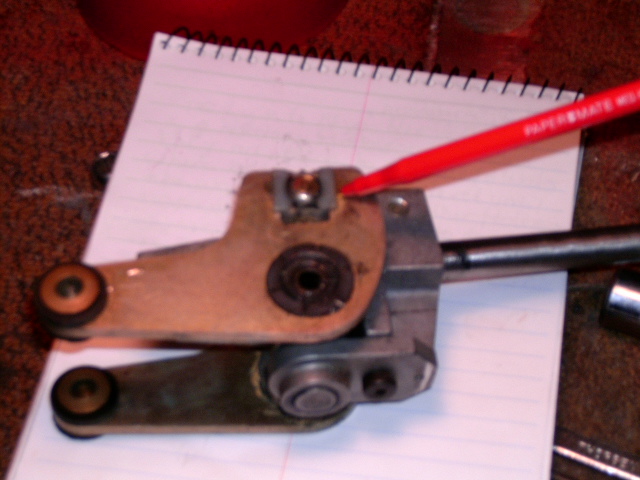

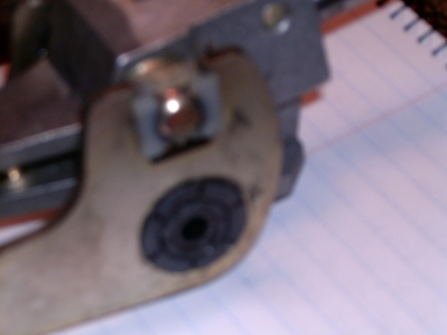

Heres one where I tried to point it out. Well anyway you GTD guys know what I need. Please help me. Thanks, Howard

I am almost sure That is the Lotus Esprit shifter assembly. The pictures are bad and I have never had mine out completely but from what I can see it looks exactly the same.

Howard, just have new ones made out of oil impregnated bronze. If you can't find a shop out there to do it, send it to me I'll help you out. You could also use Delrin, but I'm not sure if it will hold up like bronze. You might also consider bearings with spherical centers. It looks like a ball bearing but the center is a spherical ball with a hole in it. Press these into a outer case that represents the outer shape of the current part, then you can pass through it with a shaft that's welded or threaded back into the shifter. Hope this makes since??

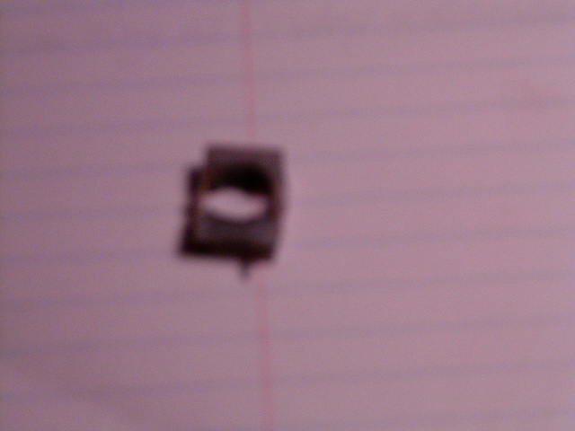

Thanks everyone, I made one myself last night out of some Derrin (sp?) I had on hand. Kind of a one off, make it by hand, fix.
