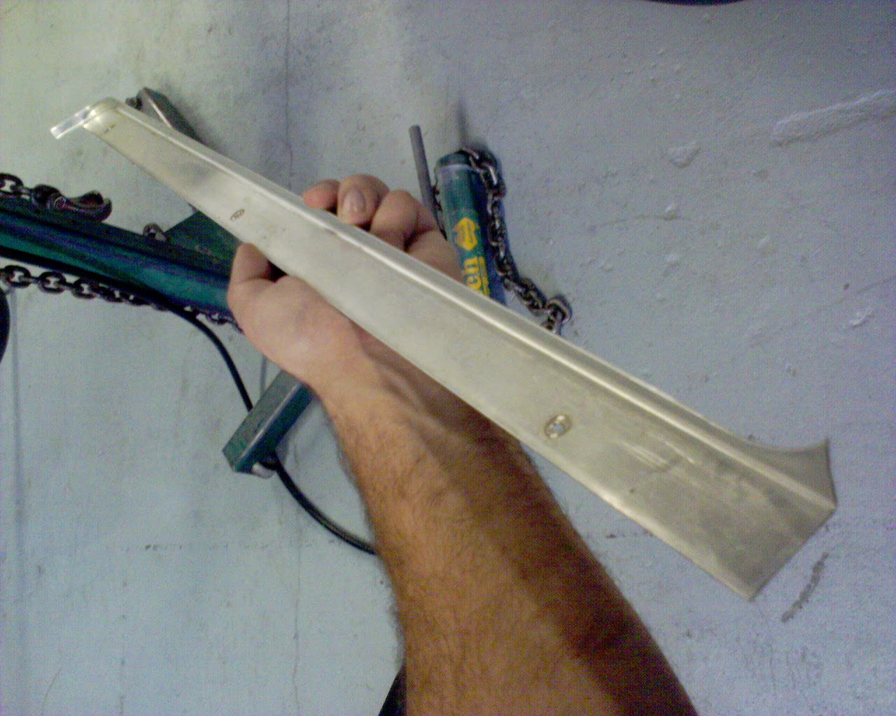

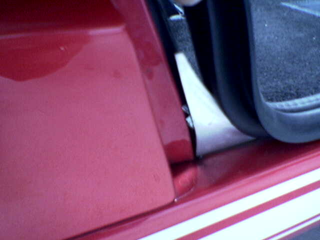

I'll show you a series of RF trims for weather sealing the bottom of the doors, about 3 or 4 photos...
#1

The flat section with the holes sits on the sill and the pointy end closest to camera points towards the back on a RHS door, like this:
