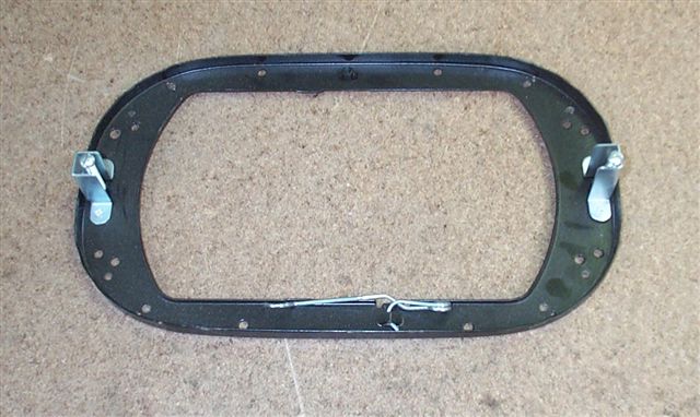

I believe the headlight mounting rings are those of the vauxhall viva hc ,can any one confirm this ,or even send a photo of the item.

here's an attemp to send a photo of the head light mounts

Ian Anderson
Yes that looks pretty close to the Vauxhall Viva ones. (Some of the Viva mounting brackets removed)
I believe they are also used on a anderson Bus (more useless information)
They are available from the Vauxhall viva club for about £36 for a pair if memory serves me right.
By the way the Valeo light does not fit this mountng - best check if you have the correct light / lens for the bracket

thanks all ,have ordered vauxhall viva mounts,have the concave lights ,sure I can alter them if need be but my local garage seems to think they are viva.

right have got the viva rings but dont fit my lights so need some one to tell me what rings the concave lights fit to,or if possible a photo of the concave light mounting rings. he ones shown in th text above are definitely viva hc rings
Have been to MDA who have mounting rings to fit the concave lights at 105 UK pounds however, these will have to be attacked with a jig saw to get them into the space required, the light area of the mda was much larger than in my rf!!

finally have taken simple route by using viva hc headlights and viva mounts .
These allow plenty of room for adjustment and easy fixing.
These parts are also readily available from the viva club.
useless fact ,but over 2000 hc headlights are assembled each month and shipped abroad as most south american and a lot of uk buses still use them. The mounting rings are made in turkey still
