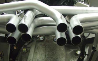

Speaking of headers, here is what was supplied by RF. Having no experience with individual pipes, is this amount of seperation normal? In order to get them into the collector they really need some force to pull them in. I am concerned this may not be best for either the aluminum heads or the exhaust assembly. Thoughts?
Alex Hirsbrunner
Hi Pat,
Do you have standard exhaust port location heads? I know that my Canfield heads move the exhaust ports up vertically about .400" which results in about .280" horizontal displacement (outwards) per head. I'm guessing it would result in about what is shown in your photo. Looks like a short tubing spacer of that size welded into the two crossover pipes per side at the rear where they run perpendicular to the car would solve the problem.
Al
