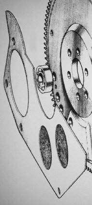

Bill,
I've seen a picture of a plate somewhere but cant hunt it down at the moment..... found this it might help.... let us know how you get on, I will be cutting mine sometime soon.

Doc-
Thats the plate. Before I set out to make one, I'm going to call Kennedy Engineered Products to see if they have one already made.

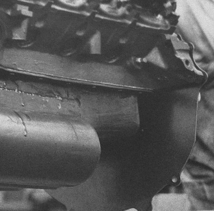

Doc Watson
Ahhh found it.... is the hole for the starter? and why is it not covering the engine/bellhousing interface? Anybody?
