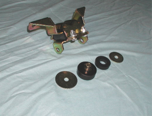

Thanks Howard, that's what I was hoping for. I have not installed the parts as of yet, but I don't see that I'll have any issues.
The Transaxle mounts are Energy Suspension part number 9.4101G, they come as a pair and are listed as a universal mount for harsh conditions. The hole in the frame has to be opened up to allow the insertion of a bushing and the lower poly bush and washer have to be trimmed to nestle into the lower part of the angle underneath.
The Motor mount is a Prothane Part number 6-503-BL, listed as a Mustang Motor Mount v-8, 65-73. They are a little wider than the Autozone inexpensive plain jobs that I have, but I don't see any issues with trimming my frame mounts (Roy Smart items) in a bit and re-drilling for bolts.
