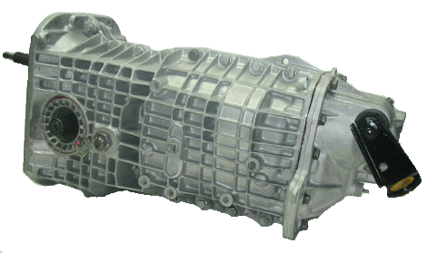

I got a mate,-- right ! Maybe an equal alternative to the becoming scarce G50 . Reportedly, used extensively in off road applications (dune buggies) where they endure some severe shock load treatments.
Just gotta do up a pattern for the various bell housings

Aah! nope, don't know much about them at all --But they look pretty tough and these are fitted with a 3.44:1 4 pinion diff and the gear shifter is nice and simple as well
In the UK they were fitted to the Vans
Renault Master FWD 2.5 Diesel (R5) (UN5 Gearbox) 2499cc 235 3/89-98
Renault Master FWD 2.5 Turbo Diesel (R5) (UN5 Gearbox) 2499cc 235 3/89-98
They have been used for quite some time by off roaders

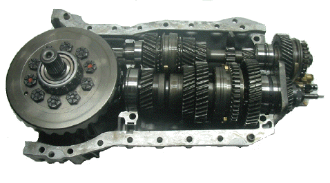

Hmmmm whats that adjuster nut or whatever it looks like just behind the output shaft on the lefthand side???
flatchat(Chris)
A piece of Aussie ingenuity, that -- found to be particularly useful in the off road applications where a bit of crown wheel flexing seemed to be apparent after an airbourne manoeuvre in rough terrain. ( simply a bronze bump stop )Probably not needed for a GT40
