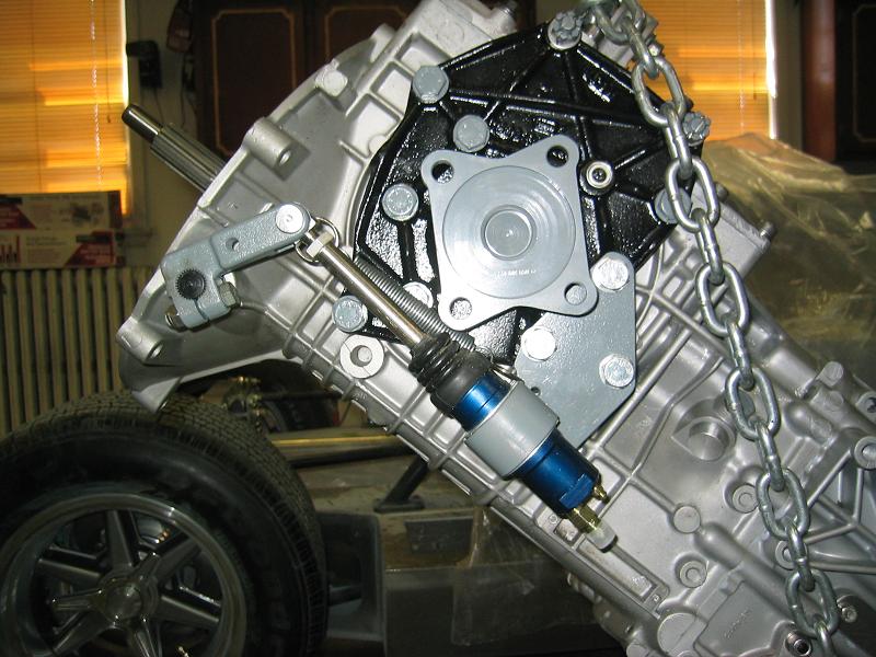

The external activation is in a pic on Ron's build:
http://www.gt40s.com/forum/attachment.php?attachmentid=13034&stc=1&d=1142294940
The slave cylinder pushes or pulls on that bellcrank to apply the TOB to the pressure plate. The internal reference is an annular hydraulic piston arranged around the input shaft on which the TOB rests. Simpler, yes- in total parts and such. More complicated due to the configuration of the piston and the effort to repair/replace.
There was another pic somewhere showing the interior of the bellhousing with the throw out lever and other hardware installed but I couldn't locate it. Maybe it was Ron's too or someone else knows where it is.
