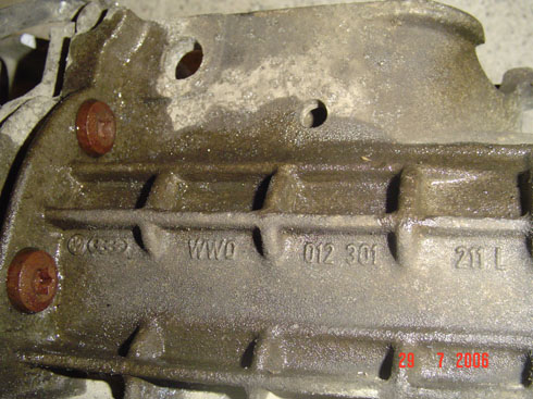

WWO 012 301 211 L GERMANY 3
(Doesn't the "012" mean that it's a 012 gearbox?)

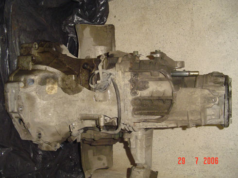

Added a picutre.
this is the view from the top of the gearbox.

Its defintely not an 01E box, as they have a cast iron gear casing (look at the black bit in the link you posted). Also, the gear linkage looks to be coming out of the box in a different location.
I will have a look on the VAG parts list and see if I can find what it is.
What does the paper label say on the top ?
If you roll it over, does it have a metal tag attached to the bottom with a partnumber on it ?
The number you see is the casting number only, whereas the tag would have the actual build configuration of the box (which make/model of car, and so which gear ratios).

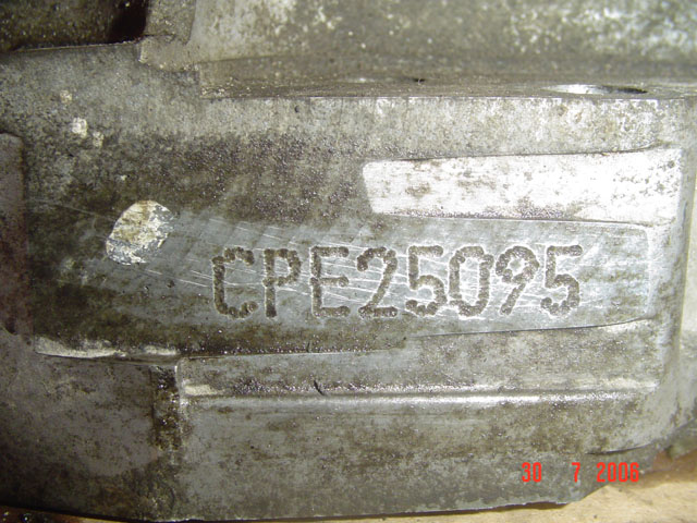

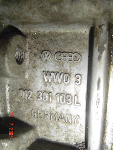

Found a couple of other numbers.
One of them is almost identical to the first one I posted, and the other one looks like the one you wanted:
WWO 3
012 301 103L
GERMANY
CPE25095

012 gearbox
hi espen, I did some digging through some saved pdf and i think this is what you have This particular
gearbox came
from an
1995/1996 Audi
A6 2.5 TDi. This
gearbox type can
also be found in
VW Passat's as
well as Audi A4's.
have a look at this site it may help http://www.v12diablo.co.uk/gearbox.htm as this looks like what you have, and there is some usful tips.
also have alook at this site it lists most of the audi late model boxes, http://www.dieselschrauber.de/audi_zuord.html unfortunatley not yours but most of the 012 listed range from 61 to 81kw it may also help another member find some info
Regards
Lambo
