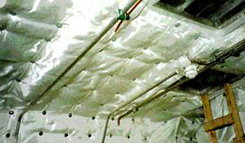

It might be a bit of work but I was thinking you could glass in a few studs that could go through the insulation and then secure with fender washers and nuts similar to the way they secure insulation in a marine engine room
Tim,
I was thinking along those lines as well. Maybe use some thin aluminum strips around the edges and down the center held on by the studs. That way it wouldn't require too many studs to be glassed in.
