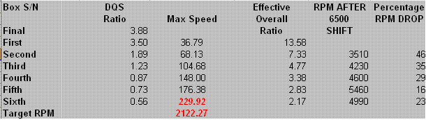

I have an Audi 01E (DQS) from an A8 and I'm looking into putting a Quaife diff into it. Would anyone know if the Quaife part # QDF8Q is suitable or would I need a different one. If anyone has any experiance with these diffs please let me know. I'm also after the gearbox ratios if anyone has them.

Jerry Jansing installed the Quaife in my 01E and is very knowledgeable on the subject. I'm sure he would be able to help. I'll PM you his #.
