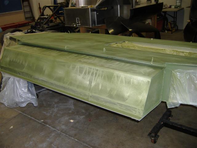

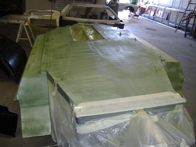

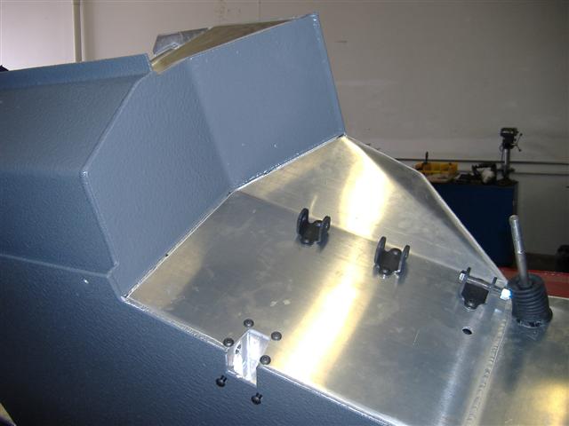

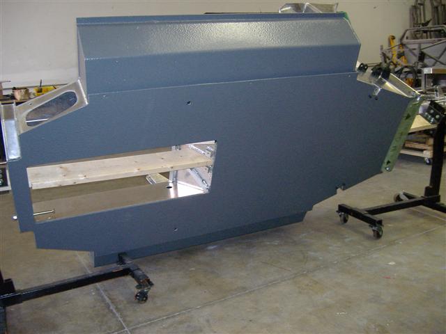

Due to popular demand we have decided to offer a rubberized coating option for the chassis underside.....
We feel doing this at he factory prior to the roller packages being assembled and shipped will help with the cusomters build process,. .
The coating is applied to a heavily scuffed chassis once the surface has been treated with a 24 hour surface etch/primer and then a 1 hour adhesive treatment....
Four gallons of the rubberised coating is then applied and left to cure for 24 hours ...... and gives 1/8th-3/16th thick coverage
The option cost for this process is $750 usd.

Colors?
Fran, is this SpeedLiner available only in the color shown, or would a prospective buyer be able to pick from a number of colors?
Doug
Fran Hall RCR
GT40s Sponsor
Colour is not a problem but I WILL be limiting it to very simple range as I dont want someone ordering "hot pink" and it being the wrong shade of "hot".......if you know what I mean
Dutton
Doug,
Several colors are available; Fran rattled off probably six before he caught his breath.
I asked Fran to suggest a color - and the one you see above is what he recommended. Over time, the patina of the aluminum chassis will look sharp against this shade of grey (not to mention how well, of course, this shade matches the ever more prevalent color of what little hair I have left).
