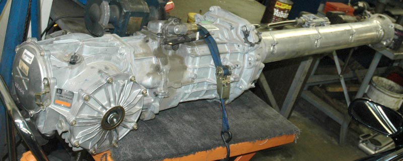

The c5 t56 transaxle is quite large and would put the output shafts very far back. I would also think that the cost would be unreasonably high. I aggree, the 016 with modifications would be a good choice.
Here is an image(if it works)

Pete, et al,
I have often wondered what one of these 'vette transaxles would do for the balance of some front engine/roadster cars like a cobra, Jag XK120 or the like.
Lynn

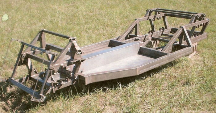

Andy,
Actually there is a guy who is a member here who DOES build midengine chassis with VW dimensions. His name is Eric Martin and he lives in Dallas. He is the principal for A & E Automotive. He was the second respondent to your initial post.
Send PM to Eric Martin
Lynn
I'm suddenly very excited!
I love the look of that chassis - especially as all the suspension design & geometry looks to be sorted....
I wonder if there are plans or any dimensions available, or anyone who owns or has built it with valuable experience?
Wow - what a gold mine find - thanks, I'll mail him now. :D
