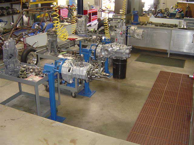

Tim Kay
In addition, in the west (USA) you can contact:
California Performance
Lake Havasu City, AZ
Bobby Hart
928-855-5755
