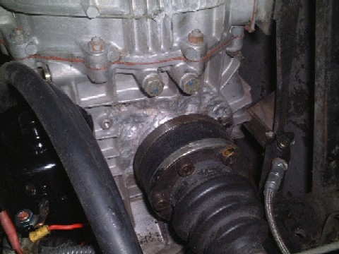

I had to go into wotk and I took a closer look at that 915 trans.
It hasnt been fliped over but like I said a lot of welding has been done on the case (diff housing) .
Its all the way around not like it had a let go its like its had a major mod for clearance.
Jim

Thanks for that Jim , any chance of some pictures ?

No , no welding involved... but his was a later version ... doing some research digging on mine ... so far, magnesium casing ... about 12lbs lighter than later ali ones ... just can't find decent enough pictures to determine if the casings are different in shape.
I dont know the reason for this.Looks risky
You wanted a pic so here it is.

Hmmmm. Not very pretty. Hard to tell from the photo but looks more like gluing broken pieces together rather than a nice even build up to allow internal machining.
