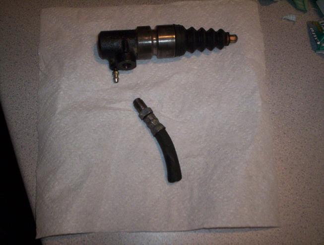

016 Slave Cylinder Adapter
OK 016 people....what adapter are you using to convert the metric thread
to AN line, and where did you get it?

Hey Mike
You back on the DRB build?
I had the same problem, I just cut the metal crimp of the existing fitting
,removed the rubber hose, cut the hose barb off ,drilled a hole in the fitting
to suit a 10x1 tap and then you have nice adapter, Worked well. If you need pics let me know.
Any good hydraulics shop can help.
I ended up using a Speed Flow adaptor to change thread, then -3 braided hose and nickel plated hose ends. All are readily available.
Try Enzed, Tyco, Earls, Speedflow, etc.
Good question, let's keep this up here and find one. I don't even have an old one I can use to make my own hose.
Ron
Though I haven't looked at the slave I have (inverted flare or bubble flare?), but you might check the Earl's (Holley) catalog: Holley Performance Brake System Adapters Products . Try one of these two: 592042ERL, -4 x M10x1.0mm inverted flare, or 592045ERL, -4 x M10x1.25inverted flare.
You could also disassemble the slave and drilll and tap it to 1/8-27NPT. From there, you can adapt anything.
Andy

MikeD
I checked the slave cylinder I have, and the fitting requires an M12x1.0 thread and concave end (inverted flare). I checked Goodridge, and they catalog a -3 jic to M12x1.0, P/N 306-03-M121, or a -4 jic to M12x1.0 P/N 306-04-M121. As it turns out, this was not an easy fitting to find in the usual sources.
GOODRIDGE USA | Motorsport
Andy
Andy
Thanks for that, Andy. I think I'm going to order one of those for my RF. The RF build manual stated that 1/4" hard lines (-4) are used for the clutch because, unlike the brake lines, a fair amount of fluid is displaced to engage the clutch. Accordingly, my car is plumbed with 1/4" hard lines. But the flex hose adapter that RF supplied to go from the hard lines to the clutch is -3.
Just because I'm anal about such things, I'd prefer my flex line to be -4.
Thanks again Andy.
I never looked at Goodridge's catalog...man what a list !
If you can't find the fitting there...it doesn't exist!
MikeD

Keep in mind, that this would likely be the adapter for the slave cylinder that I have, which may or may not have the same fitting requirement as the 016 (though it probably is). I would have prefered to use the standard 01E slave, but couldn't locate the quick disconnect fitiing.
Mark, did you check out their pre-made hose section?
Yeah, Goodrgidge has about as complete a catalog as you'll find anywhere. In the Motorsports section; did you guys check out the fuel filler caps??
Andy
I'm using the 306-03-M121 Male JIC adapter on my slave and it keeps leaking slightly. Are you guys using anything to seal the metric end (I know not to use anything on the -AN end)?
