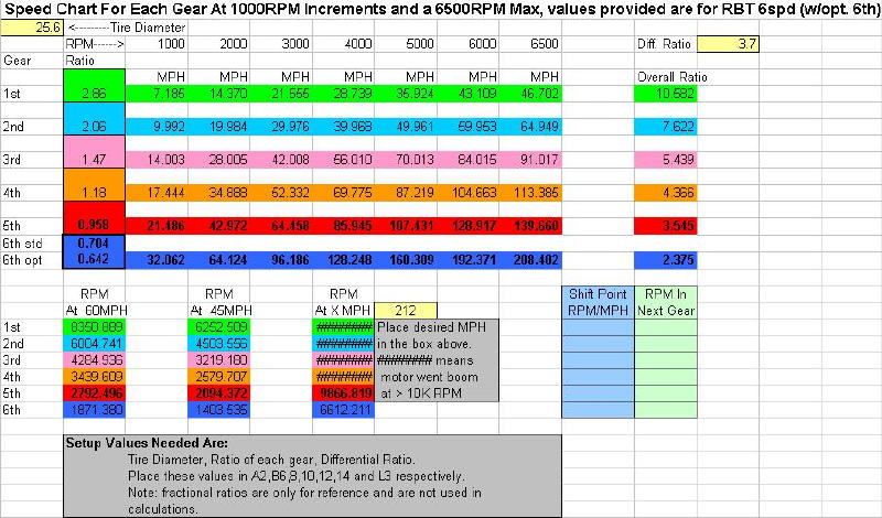

BTW, Gear Ratios for the RBT-6:
3.7 Ring and pinion
1st gear: 2.86
2nd gear: 2.06
3rd gear: 1.47
4th gear: 1.18
5th gear: 0.958
6th gear: 0.704 (Opt: 0.642)

Here is what the RBT 6 looked like in my little RPM/Speed Tool (attached):

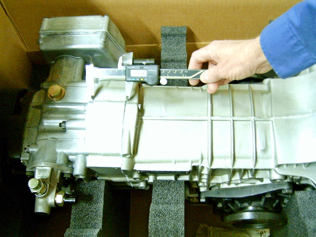

Go with the ZF, good enough to win Le Mans twice, good enough for the Salleen S7, Shelby Series 1, good enough for original spec, good enough for me. Attached is a pic of the ZF/RBT6speed we're putting in a customer car. It's about 55.4mm longer than the 5sp and comes with a reverse switch and speedo drive. Clutches, Bellhousings and Throwout Bearings are no problem.

Canuk40 said:
Hi Bernard,
I don't buy that discussion at all. The ZF is an excellent and strong box, not at all in question, but the Lemans small blocks didn't make anywhere near the power/tq that we are making today, given that Bernard is likely to make 500-600hp with his combo, you can't compare that to a 60's 289, and the race S7's that I have seen on the track are running XTRAC's not ZF's (Don't know about the Series one).
Again, the ZF is a very good gear box, but looking at it because of historical reasons is not the only factor that should be concidered.
Sandy
Thanks for everyone's response. Ian, is it possible for you to do a measurement if you're free to confirm the length between the axle point to the end?
