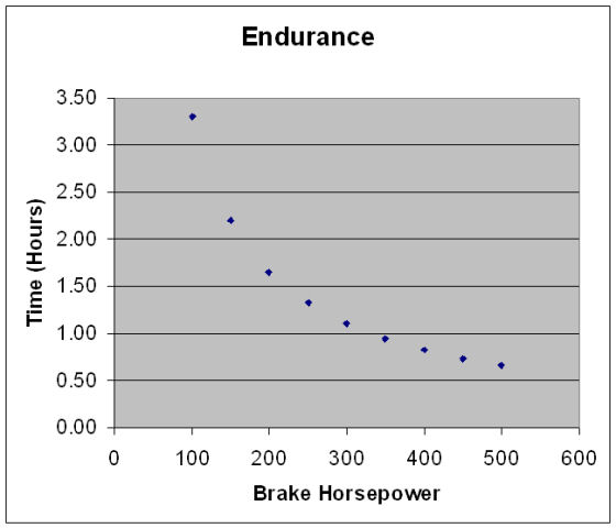

If one assumes that the BSFC of a motor we might use for the enduro is 0.50 pounds of fuel per horsepower hour, and we have 25 gallons or 165 lbs of fuel, then we can calculate a rough idea of endurance based on engine horsepower.
Doesn't look too good, does it? More later......

Well, there is no magic way around the BSFC issue. HP = (Torque * RPM) / 5252, therefore, if you wish to have say 300 ft/lbs at 3000 RPM, between the 2000 RPM and 4000 RPM you mention, then it'll require 171hp. And, a motor with that sort of power is going to have an endurance of around 2 hours at a BSFC of 0.5.
The BSFC of the motor we run is a big player here. For gasoline engines it runs around 0.40 to 0.60. If we can get it down to 0.40 for our engine then things improve. For example, a 200hp motor at 0.5 BSFC has about 1.65 hours of endurance, while the same motor at 0.4 BSFC has an endurance of slightly over 2 hours......(Auto engineers feel free to jump in and correct this mess). I have no idea what our particular engine will have for a BSFC, and I'm sure the BSFC will vary depending on what RPM range the engine operates in too.
Diesels have a BSFC of around 0.28 to 0.38 or so, and if we had one of those with around 200hp and figured a BSFC of about 0.33, then we'd have 2.5 hours - that'd be fantastic.....hmmmm..........a Passat Diesel engine has a N-S orientation, can be had with a six speed, and can make the required amount of power.......

FWIW the Porsche GT2 I drove in this years Silverstone 24 Hours was rated at approximately 345 bhp and 350 ft lbs of torque. It was fuel injected. We revved to 7400 rpm. Our fuel capacity was 120 litres. We tested fuel consumption during the few stints we got prior to the engine dying. We would have been able to do 2 hour stints as we used roughly 45 litres per hour which left a healthy safety margin for pace car periods screwing up calculations during a stint.
Maybe of help?
120L is 31.5 gallons. 31.5 gallons is 208lbs of fuel. Plugging 350hp into the equation with a BSFC of 0.4 lbs/hp*hr yields 1.5 hours of endurance.
So, it appears in your case the equation is way conservative. And I sort of figured this rule of thumb thing would be off because the BSFC is per hour of solid running, it does not take into account anything else so it would be a worst case scenerio.
In your case it is off by around 30% or so under real-life conditions.
If we can assume that for a moment then a 250hp motor will give us at least 2 hours of running minimum at 0.4 BSFC, and maybe as much as 2.7 hours of running - that would be more than enough. I think if we could get driving stints right at 2.25 hours then we'd only need probably five stops (accounting for yellows, pit time) to finish the race. And I bet we'd be first with such a car.........
