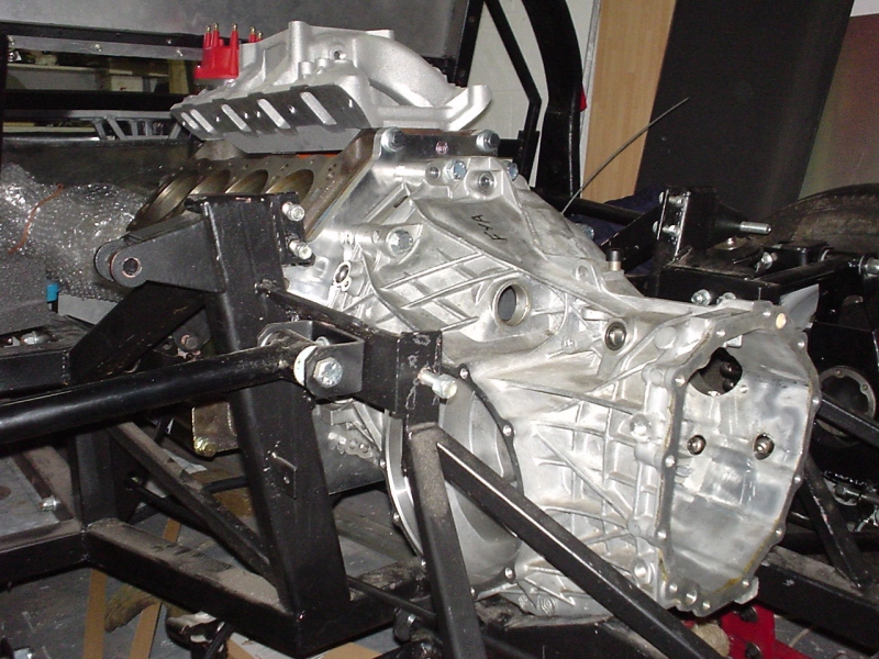

Bingo... Just got to work out all of that out now
Alright, I got you fellows now. The plate is fine, the goodies have to be worked out. Mark said that eariler, I just didn't put two and two together for some reason. Sorry for the digression.
